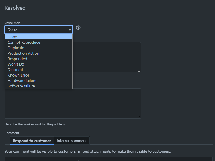

I tried this and I couldn't get it to apply to the dropdown menu. I used both words and numbers (assuming the options had ID numbers associated with them). Any idea what I might be doing wrong?

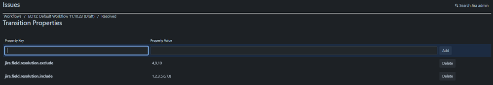

Here is the screenshot. The numbers are arbitrary attempts to make something happen. The first pic is the properties screen for the "Resolved" transition in my workflow. The transition is the same for all Resolved transitions (I set the Resolved status to be available from all other statuses). I check this by looking at the Resolution dropdown menu on the Resolved transition screen (2nd pic). As you can see, there is no change from the default. I've also tried removing just the Production Action option by using the term "Production Action" in the exclude property. Nothing changed then, either.
Your configuration should look something like this
You can only use the Resolution ID's, separated by a comma.
You can get the resolution ID by navigating to the resolutions configuration, hover your mouse over the 'edit' link next to a resolution, and look at the url that will be called. It should contain the 'id' parameter. That is the number you need to use.
Also, try only using the 'Include' configuration first to see if that makes a difference

Okay, thanks for the help. None of that has worked so far. I might be editing the wrong properties? I'm making the changes on the transition properties, but the options in the Transition screen aren't changing. Is there somewhere else I should be doing that?
Difficult to troubleshoot remotely.
If you are making the changes to the correct workflow, add the property to the correct transition and use the correct Resolution ID's, it should work. I've used it multiple times without problems.
