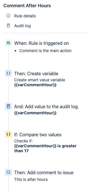

Hi @Sampath - Here's a rule that should do the trick:
Quick explanation...

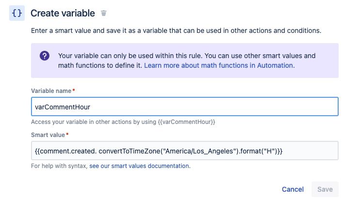

The rule triggers when comment is added. From there, the current hour is captured in a variable (second screenshot). Then, an advanced condition verifies whether that hour is greater than 17 (5:00 PM) and adds a comment. You'll just need to adjust the time zone parameter in the variable and the desired end of day hour for your needs.
Here's the variable so you can copy/paste:
{{comment.created.convertToTimeZone("America/Los_Angeles").format("H")}}

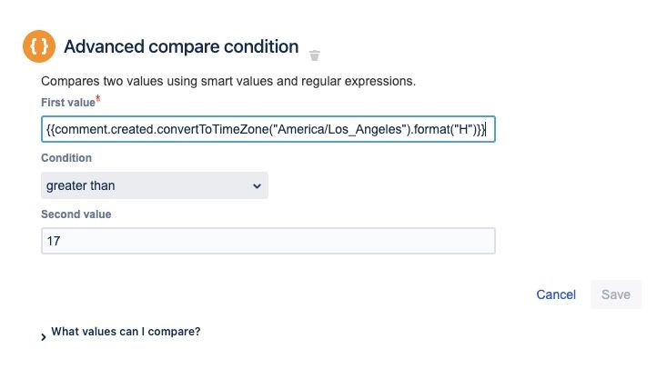

Oh sorry didn't catch that you're on server. Instead of using the variable, you could just put the smart value directly into the advanced compare like this:

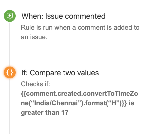

@Mark Segall Thanks again for your valuable support . PF rule set up and advise is this correct?
here i want to check in 5 minutes is this correct :
{{comment.created.convertToTimeZone(“India/Chennai”).format(“M”)}}
and we need to give the current time is 21:00
You changed the format to use "M" which is month. "H" is hour in the 24-hour format.
Hi @Mark Segall
Oh ok then {{comment.created.convertToTimeZone(“India/Chennai”).format(“H”)}}
currently time is 22:00 after hour i can check the comment status
