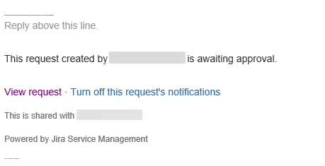

Hello! We have a Jira Service Management Portal that we are using to allow internal employees to submit requests to our IT team.
We had a report of a user not being able to access their requests via the email that is sent to them, it just takes them straight back to the portal.

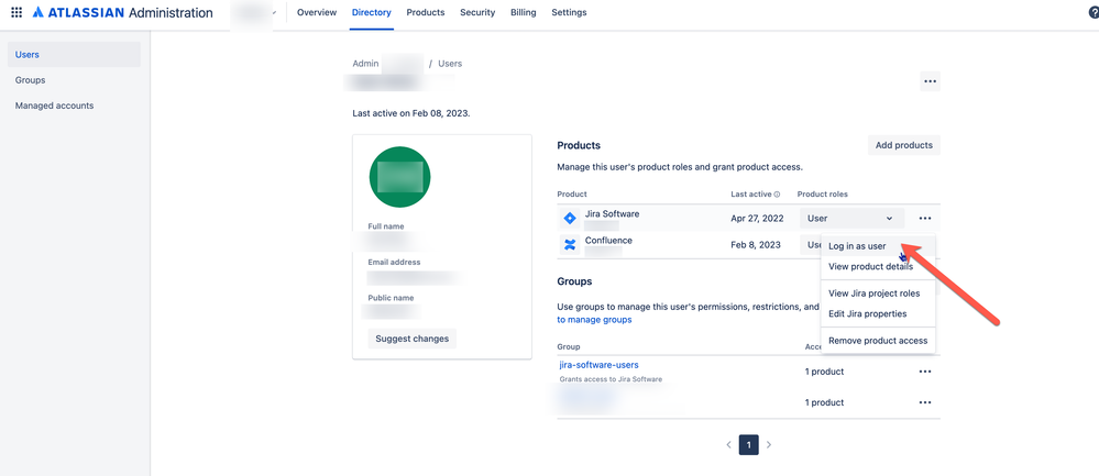

Hi @Jordan Trinklein ,
That sounds correct.
That's why I'd recommend confirming no access when you log in as that user. If you are able to access when "Logged in as" them , you know something else is going on.
The log out and log in step shakes out scenarios where the user has accidentally logged in with a different account not on the domain you'd expect (maybe one they created with a personal email).
This is a common case I run into: a user can't access portal or portal links, but looked logged in since they have an avatar in top right. They are in fact logged in just not with the right domain email.
If you log in as the user and you also can't access request then it would confirm permission issues.

Joshua Stokes
May 14, 2025
Hello @Jordan Trinklein
I know this ticket is old but thought i'd ask how you got on?
I have an issue at the moment where a user clicks on 'View Request' from the Jira email they receive, but it just brings up a 'No Access' 'You do not have permission to view this request'
When they seemingly appear to have access, hence why they got the email.
Any ideas on this one?
