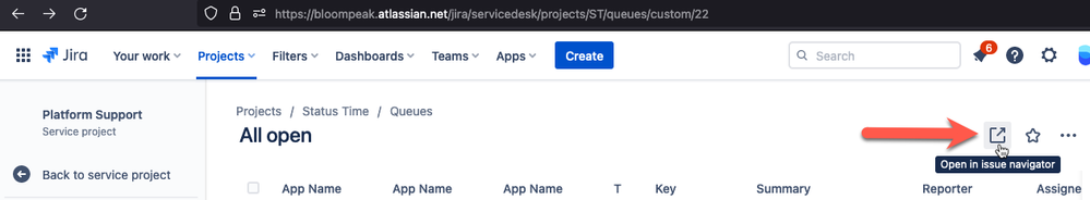

Thank you for the update. We need a report that will tell the user a start and stop time for an issue. When creating the Automation rule, will this populate in the queue via a column for export purposes? How will they get this information in a report?

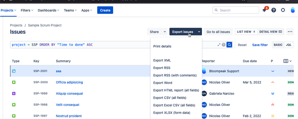

Yes, you can add custom field to be displayed in your queue. I am not sure if queues are exportable but you can open the queue in issue navigator as in the below screenshot. In issue navigator you can display the custom field and export the issues into MS Excel

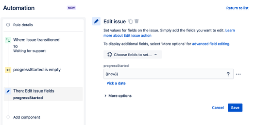

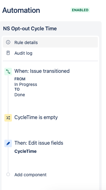

Automation rule will calculate the custom fields. The first rule be similar to do below one.
Similarly, you will define the second rule and set the CycleTime field as {{progressStarted.diff(now).seconds}}

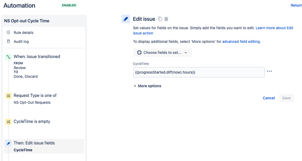

Thank you I created two Automation rules, however had a question for CyceTime rule. Should this condition be "empty" also similar to progressStarted?
It depends on when you want cycle time to be ended. If an issue has transitioned to Done multiple times(e.g New -> In Progress -> Done -> In Progress -> Done), do you want cycle time to stop in the first transition to Done or in the last transition to Done? If you want it to stop in the first transition use the empty condition.

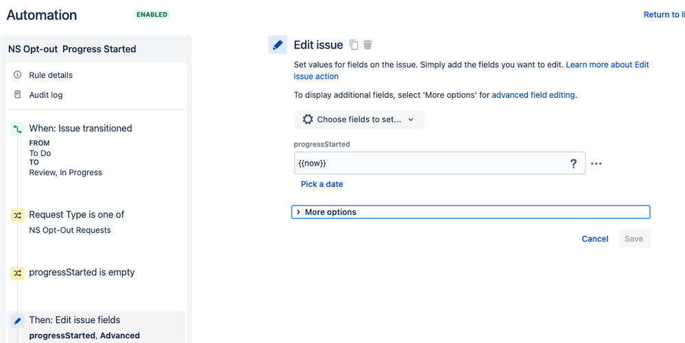

Does it have more to do with my smart values or the rule itself. For smart values I used what you suggested and added a condition to only capture a certain request type.
The rule produced an error, however it was for the incorrect request type, which is why I added the condition for the specified request type.
Thank you for the assistance.
Update, I fixed Automation rule and now the progressStarted populates a start time:
However, Cycle time automation rule does not populate any information and the rule is listed as "Success" via Audit log.

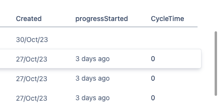

This is what shows in Queue:
Question, is the time listed under progressStarted considered the total Cycle Time?

Update:
I found the issue and also changed the CycleTime to display seconds, instead of minutes.
