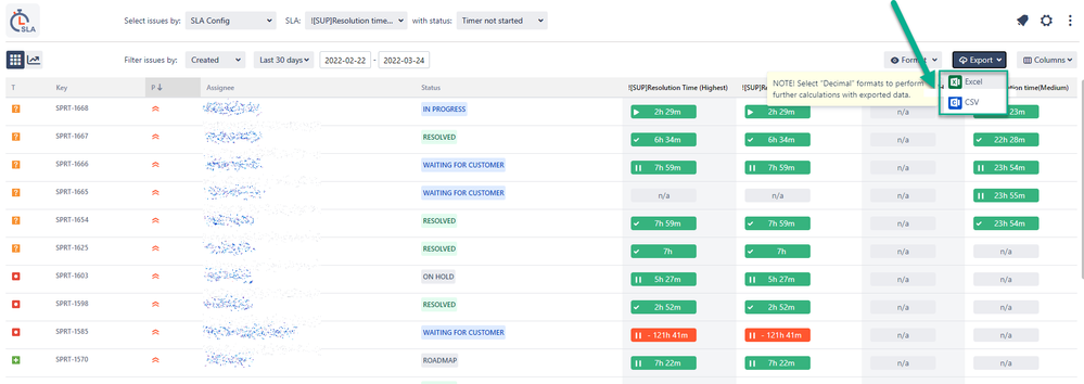

Good morning Mariana,
Thank you, but that's not quote what I am looking for.

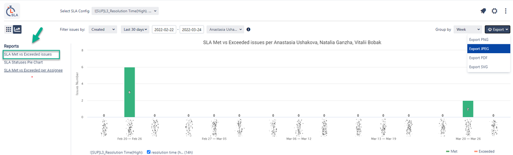

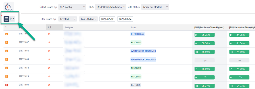

Hello @Dean Verappan
You can try SLA Time and Report, developed by my SaaSJet team which allows showing Exceed vs Met issues.
It can be shown as Charts or exported to Excel or CSV files.
Hope it helps.
