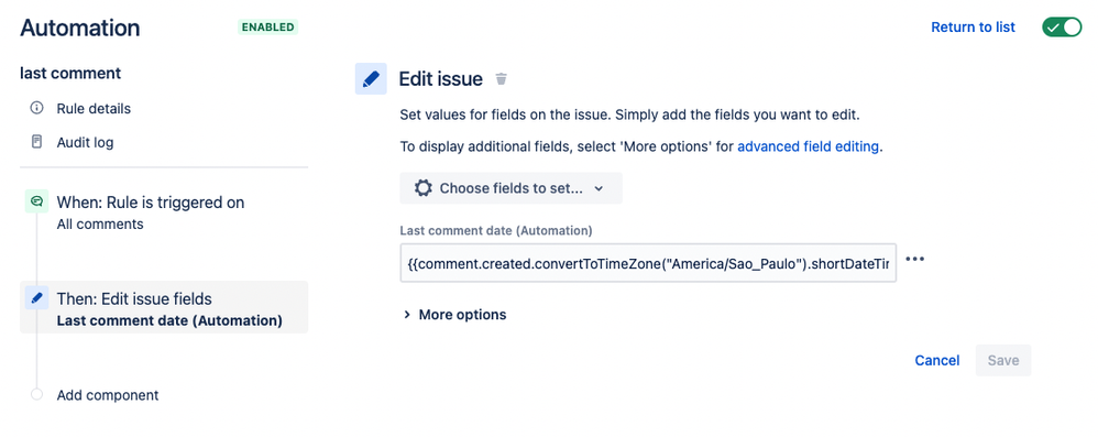

The suggestion in Community is a good option and I tested two options here.
By using the smart value {{{}issue.comments.last.created.jiraDate}} it will show the date only.
The smart value {{{}comment.created.convertToTimeZone("America/Sao_Paulo").shortDateTime}} will show the date and time based on the desired timezone.
To find the correct timezone, you can use the link below and copy the value from the Canonical ID column and just replace it in the example I shared.
Here is the result:
Hope this helps!
If I can provide any additional assistance please let me know!

What I ended up doing was actually using the {{comment}} smart value: https://support.atlassian.com/cloud-automation/docs/jira-smart-values-issues/#--comment--
The {{comment}} smart value will allow you to access the property .internal, so you can ensure only public comments are captured. This does property doesn't seem to be available for {{issue.comments.last}} However, the {{comment}} smart value only works with the comment trigger, so it's only a "going forward" action. If someone wanted to back date, it would be a bit more work to ensure you're only getting the public comments. If you wanted to do all comments, that's much easier using the aforementioned {{issue.comments.last}} smart value.
