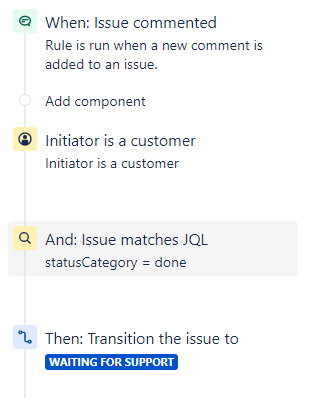

I builded a automation rule, that will transtition issue from Canceled status to Waiting for Support status if the customer put comment, like: "No, no, please don't cancel my request"

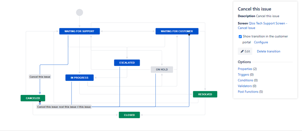

THE BIG problem is, that I would like to allow this transition Cancel Issue be visible for the customer:

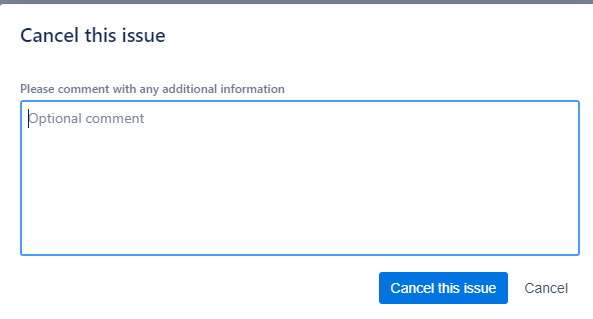

It's working fine until the customer will not add comment directly in the transition, the customer window look from portal:
So if there will be no comment, all is working like a charm, BUT if the customer will add comment here, the autorule above will happen, and status will be changed from Canceled to Waiting for Support...

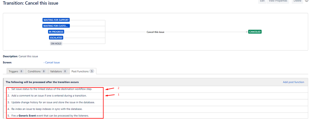

I wanted to change order of execution in transition post function, so first add comment, after that change status, but it's grayed and cannot be changed.
Do you have any idea how to switch off possibility to give comment in this transition? Maybe do you have any different idea how to do it?

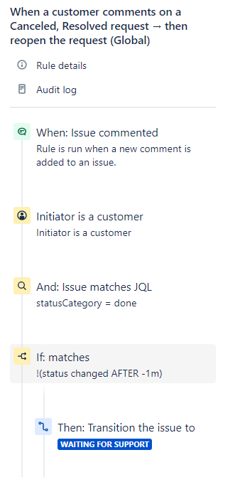

I think I found some work around, but maybe you have another suggestions: https://community.atlassian.com/t5/Marketplace-Apps-Integrations/Automation-for-jira-on-comment-but-not-from-transition/qaq-p/1417142
It's working:
