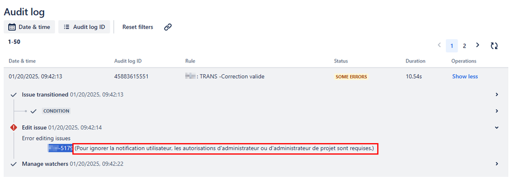

Recently started getting an error in our Automation audit logs while Editing an issue, for which I cannot see how to resolve.
My system preferences are in English, but funny enough the error message comes out in french. I will therefore translate it myself for you below.
Translated: "To ignore user notification, administrator or project administrator authorizations are required".

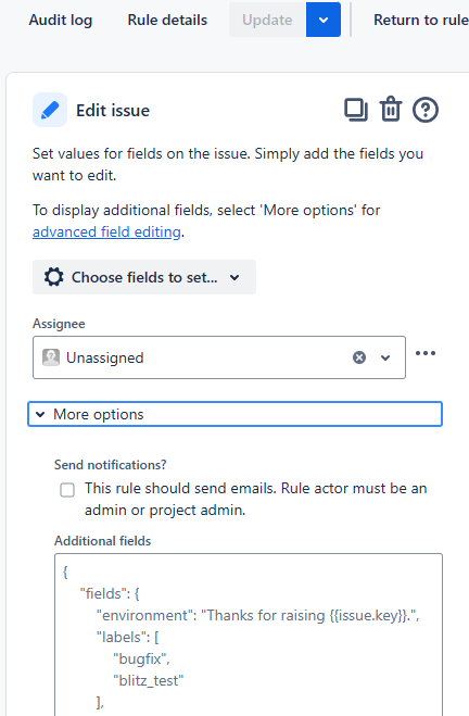

Here is the Edit issue action:
Any ideas?

Hi @Eric Bergeron , I haven't seen that error message before. However, it seems to indicate that the Rule Actor, the user that the automation system is using to take action, does not have appropriate permissions in the project.
On the Rule Details page, could you check what user is set for the Rule Actor? In most situations, this should default to "Automation for Jira". I wonder if this has been changed for your rule?

This is a new behavior, as the Actor has not changed. It's not "Automation for Jira" no, because some of our automations adding comments we want to be professionnal and be seen to our clients as though they were from our organization. We have therefore created a generic user for this. We don't want it to have Administrative rights.
Why would we want to be spammed with notification emails for every fripping automation anyway?
I understand that this is by-design (as of now it seems), and that only way to resolved is to elevate our generic user's permissions. TY
