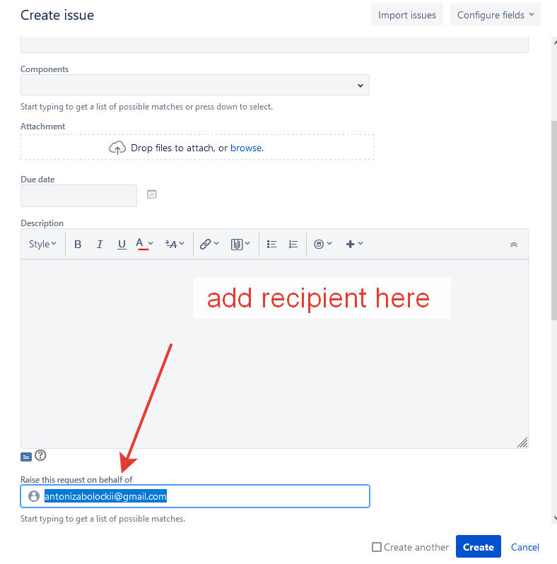

On Jira Service Management, what triggers notifications for customers are the Request types and when using the Create button to create tickets on behalf of the customer, people usually select the Issue type instead of the Request type.
With this said, for future tickets, select the Request type instead of the Issue type, otherwise, customers won’t receive updates.
For existing tickets, you just need to add a valid Request type for customers to start receiving notifications.
Also, as a workaround, if you and your team prefer to use the Issue type to create a ticket, you can create an automation to automatically set the Request type after the ticket is created.
