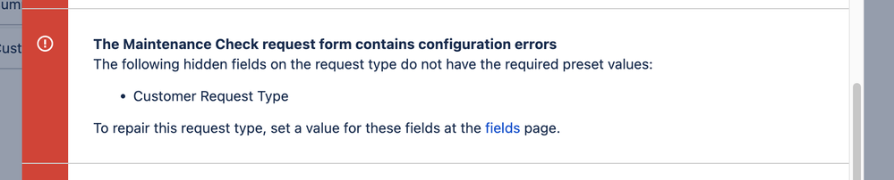

We are seeing this error when loading a settings page of the servicemanagement project:
On the details screen we see that the customer request type is causing the issue.

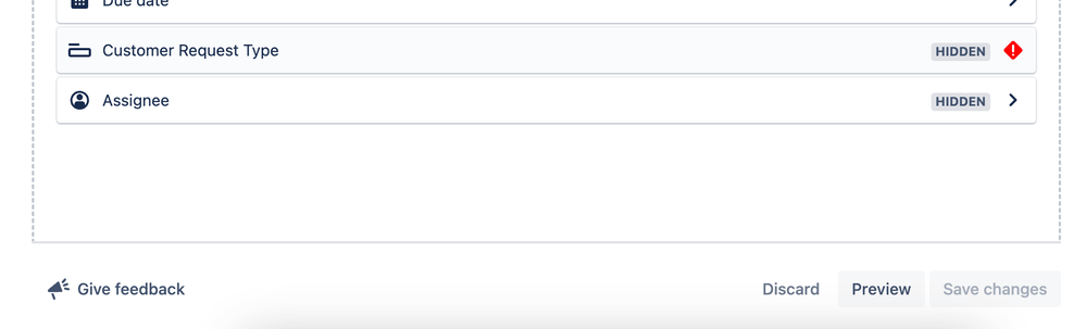

Also on the request type screen to edit the fields we see a error with that field. But we cannot change anything to get rid of the error. Also there is not a preset value for this field to be set:

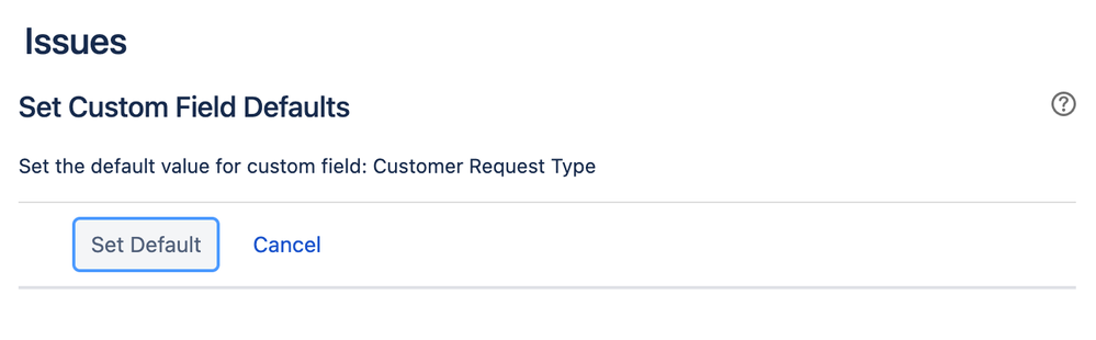

Also I searched the custom field in settings, but cannot set a default value for it.
So, I'm out of options. The system needs this field, but doesnt let me set the default/preset value.

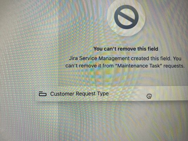

Ok so do this if you will. Drag the CRT to the sidebar on the right.
this should address your issue.
Karl van Santen November 30, 2022
No, I cannot drag it to the sidebar. Below you see a screenshot of it.
Jack Brickey
November 30, 2022
ok. what admin level are you? I wonder if you are a project admin and the associated screen scheme is shared with other projects. Can you look at the screen associated with the issuetype associated with the Maintenance Task request type? I suspect that the Request type field has been added to the screen and then added to the form. As an Org admin I can add to the screen then add/remove from the form. I also note that your image shows that the required box is checked. This is what ultimately is causing the misconfiguration. Do you have a hidden field that is required without a default value set. And as you noted you cannot set a default for it. So the solution is to get it off of your for all together. Now we just have to figure out how to make that happen. If you or not an organization admin you might want to reach out to this individual to discuss what you are experiencing.

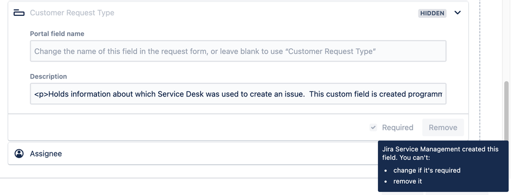

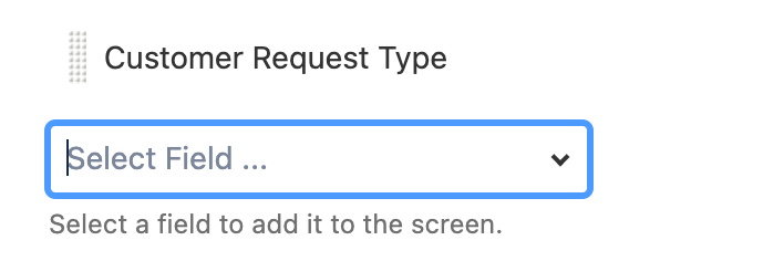

2. I can add or remove the field from the associated screen, but this does not help to remove the field or set a default value. Also, I cannot uncheck the required box. see screenshots below.
3. It says that the field is added by Jira Service Management.
I'm really out of options here.
