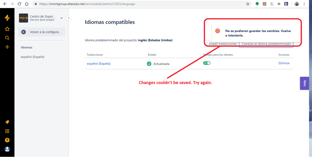

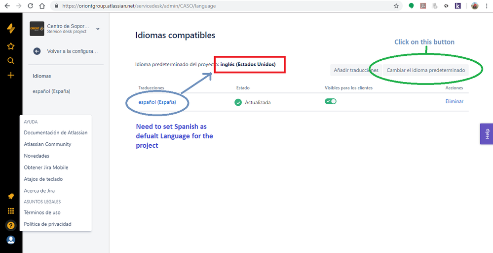

I want to change the default language of a project:
After that, I choose the desired language:
Finally, I get "Changes couldn't be saved. Try again" message. I did this step in severals opportunities, and every time get same error.
