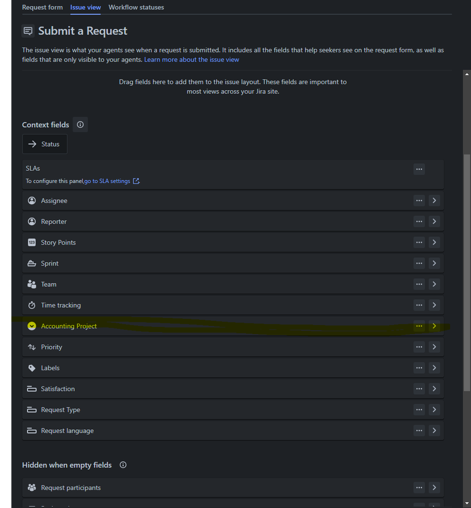

Hello, trying to figure out why a certain field disappears when the JSM issue is set to done. I have checked that it is associated to the necessary screens and the find your field check says there are no problems. The highlighted field is also configured to not be hidden, see screenshots below.

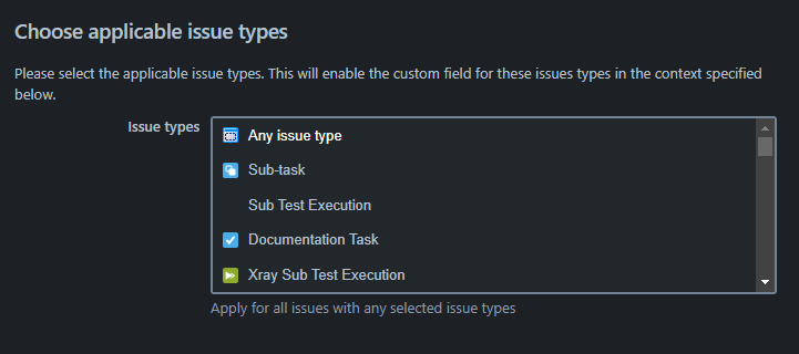

@John Funk @Asmath Basha S Thanks for the help, I had to reselect "any issue type" when modifying the configuration scheme context, since the custom field was added/configured in every screen and there was no conditions or validators for that field in relation to the done screen. Once I changed this, it showed up.
