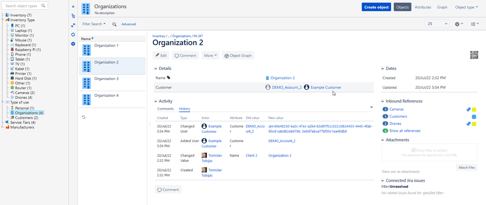

My colleagues and I just found a bit easier solution for this. The basic concept stays the same, but without the need of having to replicate Customer structure in Insight - only Organization structure is enough.
So, I'll take what Mark wrote earlier and just modify the steps a bit:
  • Object Type 1 - Organizations
    • Attribute - "Customer" (attribute type: User)
  • Object Type 2 - Data I want to present to the reporter
    • Attribute - "Assigned organization" (Reference Organizations) - it is important to use the same attribute name (for referencing organization) on each object type
Now, for the attribute "Customer" value in each Organization object, you can select any Atlassian or Customer account that you have on your site.
On the Insight Field setup, you would set it up like this:
  • Filter Scope (IQL): objectType in ("ObjectType1", "ObjectType3") - replace strings with actual object type names (e.g. "Drones")
  • Filter Issue Scope (IQL): "Assigned organization".Customer=${reporter}
Filter issue scope depends on what attribute name(s) you used before (see list items/bullets above).
