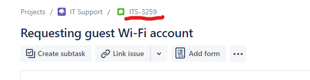

Key is the identifyer for the issue, so the issue numbers you are reffering to are the keys. They are the same.
On every issue you will se the key on the top, like shown here:
Those works in filters when using "key in" as shown here:
TimK.
