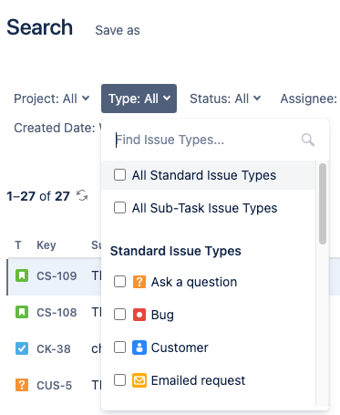

How do I construct a JQL that displays 2 issue types while also filtering the end date?
So I'd like the filter to show tickets with an end date in the last 24 hours with the issue type being either "standard change" or "CAB change"

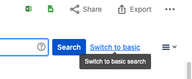

Hello @Shanara Sadeque
You would add to your JQL a criteria to evaluate the issueType field.
It sounds like you would benefit from reviewing the documentation for issue searching.
https://support.atlassian.com/jira-software-cloud/docs/search-for-issues-in-jira/
You can switch to the Basic Search option:
And then use the options available to indicate you want to search for issues of specified types by check marking the types you want to include:

...you can Switch to JQL to see what the JQL syntax looks like:
