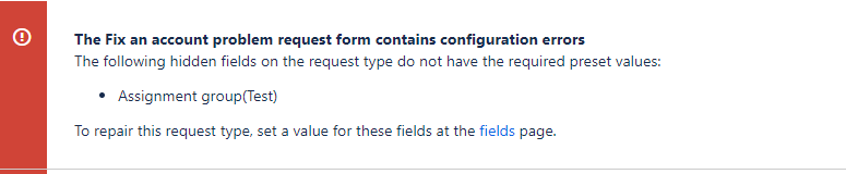

I am getting a exception when I select project setting. The exception is regarding the field Assignment group(test) I am unable to remove the field from request form "fix an account problem".
I don't need the above mentioned field in that request form. but I am unable to remove as the field is created from Jira end.
Any solution to fix the above requirement ??

I am not getting the remove option as the remove button is disabled which is provided below.
Is there any other way to fix this exception ??
