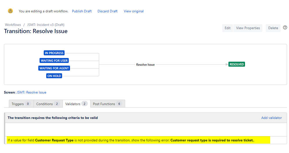

So, i tried to add a validator to my workflow to make Request Type required to sold the isssue.
Test 1 : From Jira (not from customer portal) i create an issue with no request type, the validator is blocking the transition--> Fine.

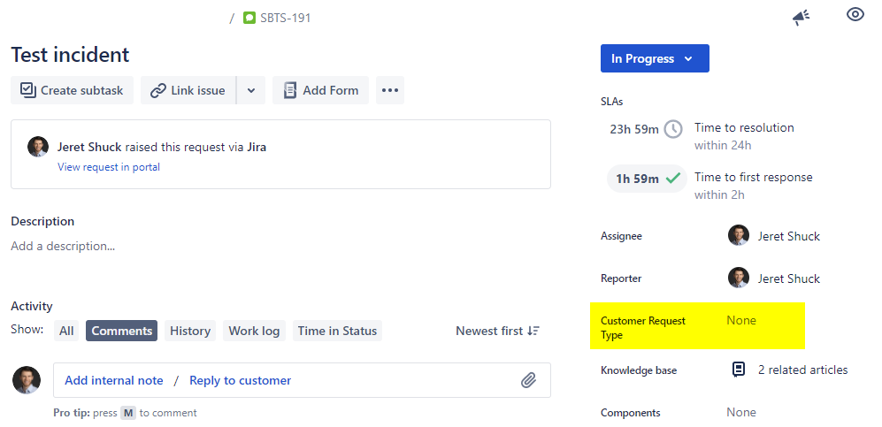

Test 2 : create an issue from the customer portal -> a request type is affected. Then i move the issue to another issue type -> the request type is now blank. I do the transition : the validator didn't stop me.
I think in back office the request type field has a value (the one from the creation) so the validor doesn't stop the transition. But in front office Jira doesn't show me the value because it's not a value affected to the current issue type. I wish that validator stop the transition and the agent apply a correct value to the request type field.

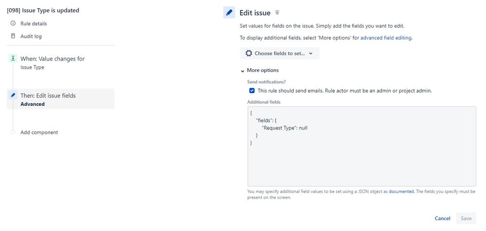

Hello everyone! I have a workaround that's working! It's an automation that simply sets the "Customer Request Type" to "Null" when the issue type changes.
Work around:
Create a new automation:
    "fields": {
        "Request Type": null
And wala! 🎉 My validator is now working, thus blocking my team from closing an issue when it's been moved, and the customer request type has not been re-populated. Hope this helps!

I was about to post it here too. I talked to Yuri and he mentioned that found this workaround where the automation will clear the request type field. With this, the validator will work, because the field will be really empty.

Hi @Michael Nassette I hope you are ok, the method is still working, in this new Edit Request Type action you can click on More Options and paste the JSON and voila!

So, the ticket is moved to another issue type, the request type shows “None”, but if you go to the issue navigator, the request type is still visible, so in the backend, the value is still there and the validator doesn’t recognize the field as empty, that’s why it won’t work:

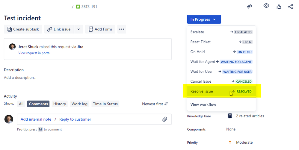

I have the exact same use case. Here's my validator:
On my test ticket, you can see here the request type is blank (after switching the issue type):
And yet, I still have the ability to execute the transition:

Hey, This is still working as with the first suggestion - "Edit Issue" and not "Edit Request type" - the automation changing the RT field to be empty and than the validation works.
