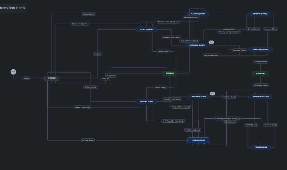

One of my projects is a suggestion portal for the company. Users can

Hey Walter,
Thank you for the response, the workflow for both did in fact end on the same completed status. I created two different ones for the Short and Long types of tickets. Now the test ticket that I created has the correct SLA assigned, but in the Project Que, the Time to Done is empty.
It is up to the agents to determine the length of the ticket. The user submitting the ticket does not have the option to choose whether or not it will be long or short. Since it will be up to the agents to figure out what needs to happen for each one, so they assign it after it has been discussed.
