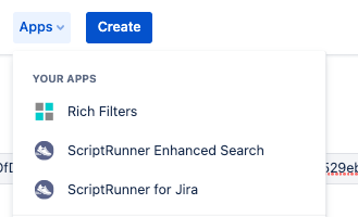

There is no option for querying based on the date of Comments without using a third party app. If you are not getting an error message when you use "commentedOn" in your filter, then you already have a third party app.
If you look under the Apps menu, do you see entries for ScriptRunner? If so, that is the third part app that supplied the "commentedOn" and "commentedBy" keywords.
I have that app myself and did some testing.
I commented on an issue today, and did a search for
commentedOn>startOfDay()
No results were returned.
I then did a search for
commentedOn > startOfDay(-1d)
and that returned the issue on which I just commented.
I then created a new issue and did a search for
created > startOfDay()
and that returned the issue I just created.
This suggests to me that there is some issue with the use of startOfDay specifically with the commentedOn keyword. I have not yet been able to discern the details of the difference.
