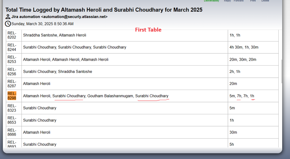

×My Email Body is as follows
My Resultant Email is as follows
Expected View should be
My Jira Automation is as follows

hie @Bill Sheboy
Thanks for the help.
Your Solution worked absolutely well.
Now my email gives me this result.
Could you help me get this into a tabular format?
Altamash
