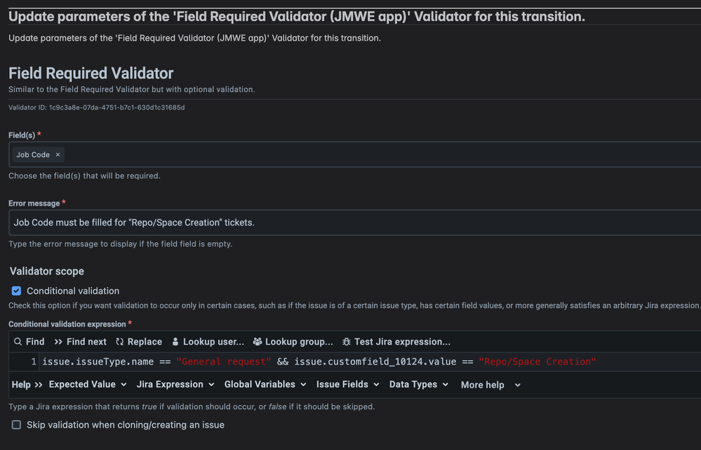

Allow me to suggest solving this issue by using Jira Misc Workflow Extensions (JMWE), you can use the Field Required Validator (JMWE app), that allows you to make a field required but with optional validation.
For you specific case, I recommend doing it like this:
issue.issueType.name == "General request" && issue.customfield_10124.value == "Repo/Space Creation"
Just remember to change the custom field value to match your instance, or the error message if you desire.
