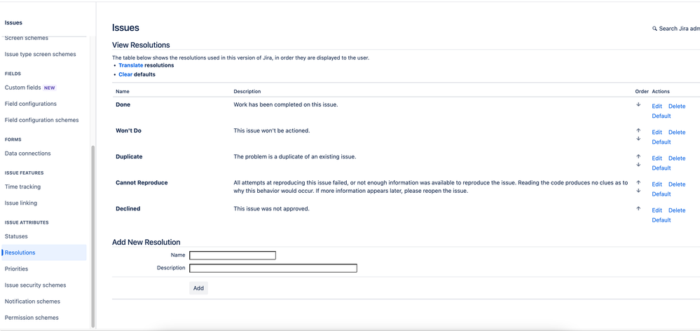

Hello @Arnis Riškovs ,
You can add Resolution values in Settings -> Resolutions:
BR,
Nikola
