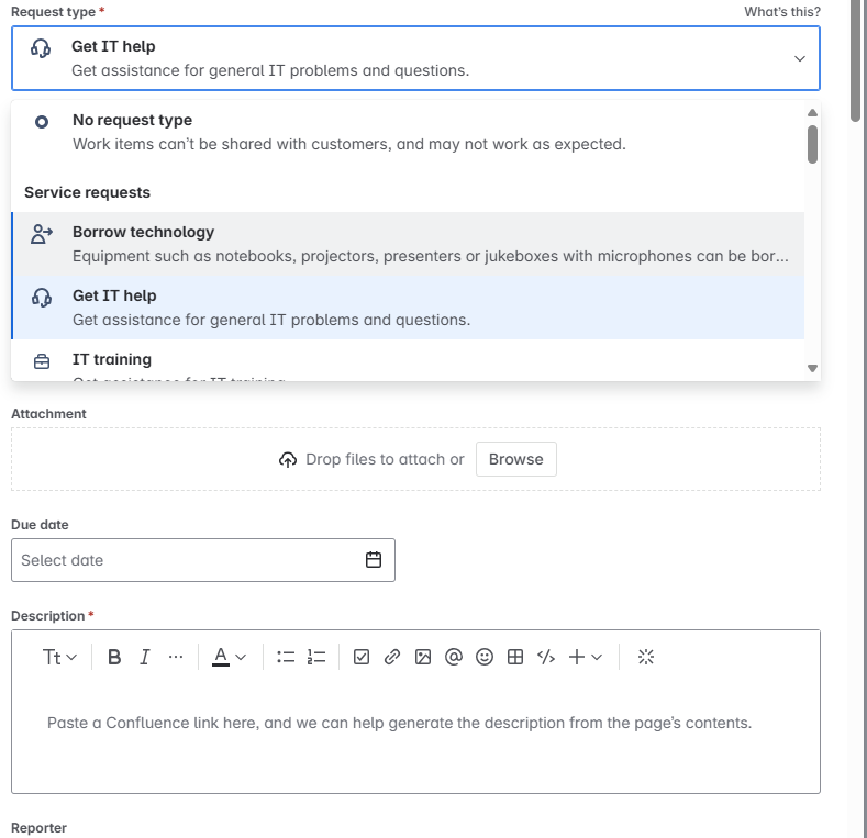

I have created a service request as an example and then we have different request types for the service request, for example “Get IT help” or “Borrow Technology”. If I now select "Get IT" help, how can I change this afterwards?
I only know that when I create the ticket, I can change/add it there in the mask, but how can I change it afterwards?

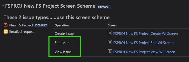

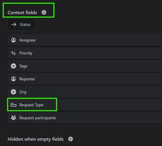

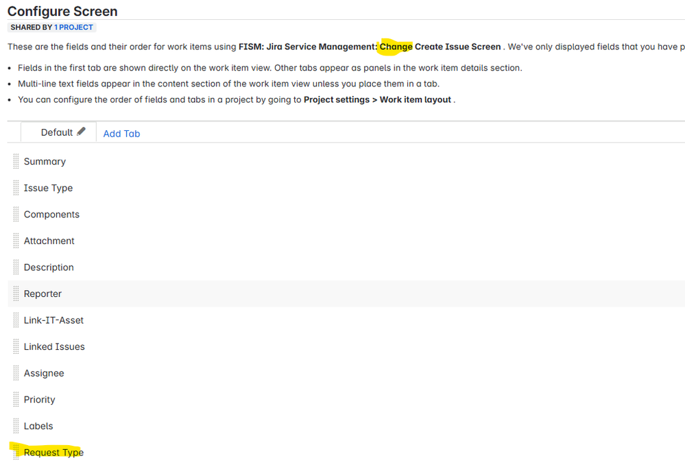

Hi @Antonia, in addition to the other suggestions, if you don't want to use a rule AND you want this capability on a regular basis, you can add the Request Type field to the Work Item View ("agent") screen layout and to the Edit/View or Edit and View operational screens so it shows up on every ticket. You'll need to add it to both View (agent can see it) and Edit (agent can change it) screens for it to be editable.

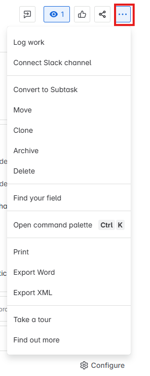

Hi @Antonia
I guess you can change it after, it’s just a bit hidden.
Open the ticket, hit the three dots up at the top, then pick “Change request type.” That’s it.
@Antonia Seems that you want to update the request type after the Work item is created. If so, then you have to write an automation tule..like
When Work-item created trigger
Then add Edit work item action
Use Edit Request type action and select the respective request type.
Ensure you should select the request tyoes that are belong to the selected work type. If the work type is different and you want to update that Request type then it will throw an error.
In this case, you need to first update the work type and then Edit request type.
