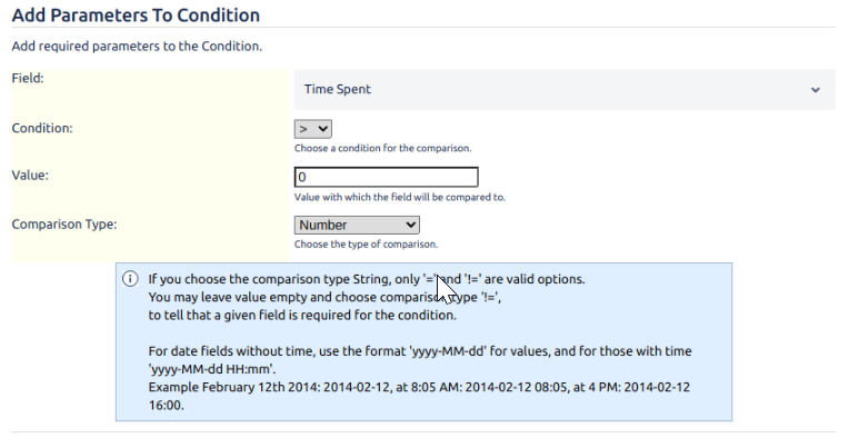

Adaeze_Jude_HEROCODERS
October 25, 2024
@tomas.vidal ,
In addition to the answers provided above, you can use a workflow condition.
A workflow condition is checked before the user is given the opportunity to transition an issue. If the condition fails, then the transition buttons will be hidden.
you can set it up as below:

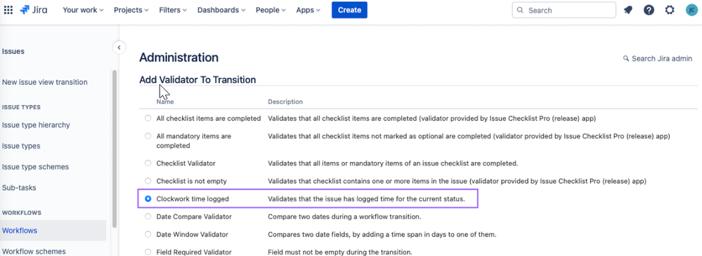

You may also explore using Marketplace Apps.
With Clockwork PRO you can also use a built-in validator to make sure time is tracked in the current status.
as below:
Both processes are documented here.

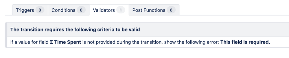

Kris Dewachter
October 24, 2024
Hi @tomas.vidal ,
It depends a bit on your specific requirements.
If you need the Agent to log time during the transition to the "Resolved" status, you can use the solution suggested by @Joseph Chung Yin .
If you need the ticket to have any spent time (so not specifically during the transition), you could add a "validator" on the "resolved" transition. The validator will require total spent time to be greater than 0
Best regards,
