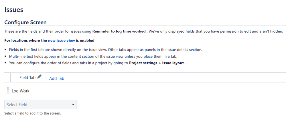

What you need to do first, is create a screen. This is what we will use as a pop-up to block people transitioning the issue unless they log their work. It can be as simple as this  -

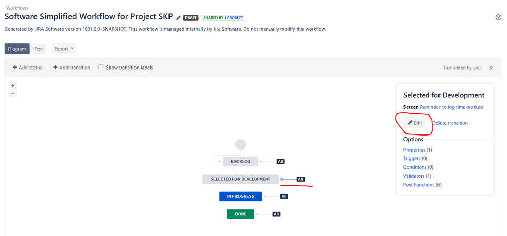

Next, in the workflow for the issue where you want to implement this, add the screen to the transition where it should be effective, like this -

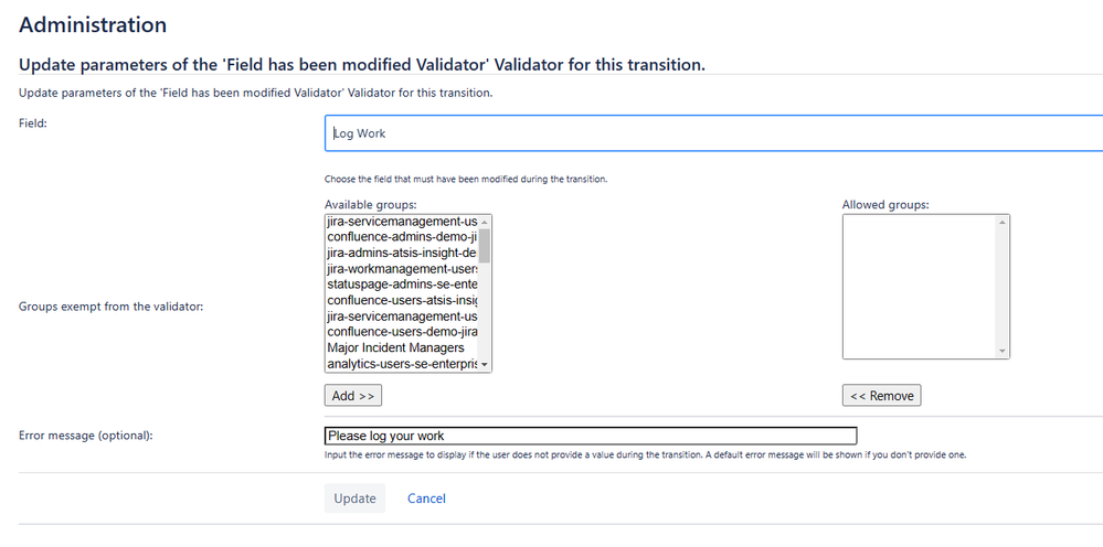

Next, you will need to add a validator. This is what enforces that something has been logged.

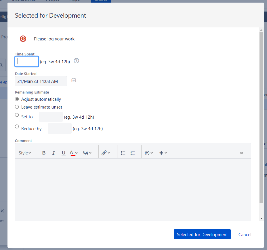

The end result is this, when I try to transition from the Backlog status to Selected for Development -

I went ahead and started following the provided steps, however the second step does not seem to be available on my end.
https://community.atlassian.com/t5/image/serverpage/image-id/246739i964000813F0991A9/image-size/large?v=v2&px=999
I have admin rights in Jira, but I am not seeing the Edit button as in the screenshot. Can you please elaborate a bit more on where I need to go to be able to access it?

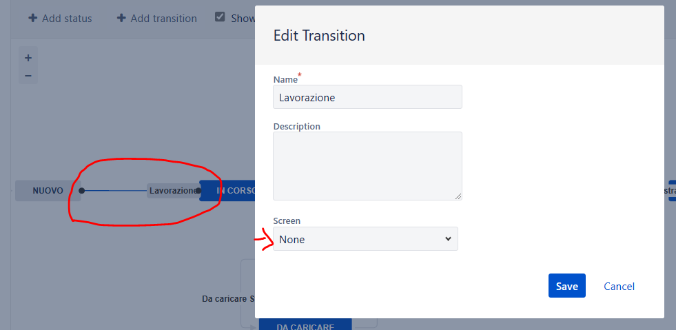

You will need to select the transition where you want to add the screen.
In the workflow I used in the example, all of the transitions are global transitions. What this means is that you can always go from any status to any other status. This isn't necessarily typical as often you will want to prevent people from just closing everything that has been opened.
Here is another workflow. If I double-click on the transition from Nuovo / new to In Corso / in progress, this screen pops up where I can add the screen, which should be shown on the transition. Then, if I hit Save and publish the workflow, the screen should be shown when I try to go from Nuovo to In Corso in a project / issue where this workflow is active.
