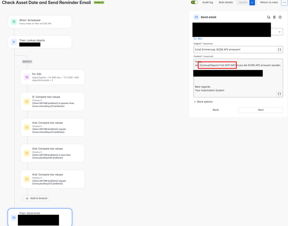

So I have built a rule that sends me a reminder email and the rule should contain the date on which I have to renew a key. The date is in the asset. I have also already built a query that also gives me a date in the mail, but the date is displayed the wrong way round and with the time. Can I change this somehow? I have already tried every formatting but none of them work.
{{lookupObjects.first.DATUM}} --> 2025-07-29T00:00:00.0+0000
??? --> 29.07.2025
Hi @Antonia
You could solve this by 1st creating a variable.
Then in the email use {{<variable-name>.toDate.jiraDate}}
Does this give you the required output?
I tried it but no date will be put out.
I tried this in the mail too: {{<variable-name>.toDate.format("dd/MM/yyyy")}}, but it doesn't work.

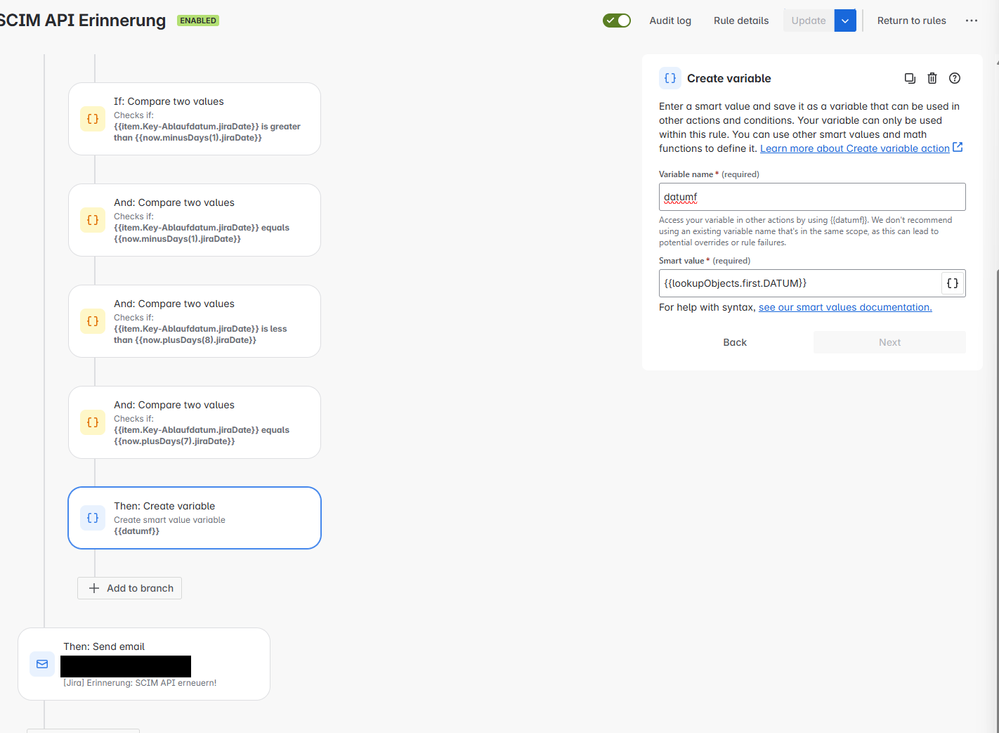

So, I moved "And: Send email" into the branch and the "create variable" is above this action. But no e-mail is getting sent. When the Aciton "And: Send email" was not in the branch, emails were sent out.

Where in the rule should I put the action with the variable?

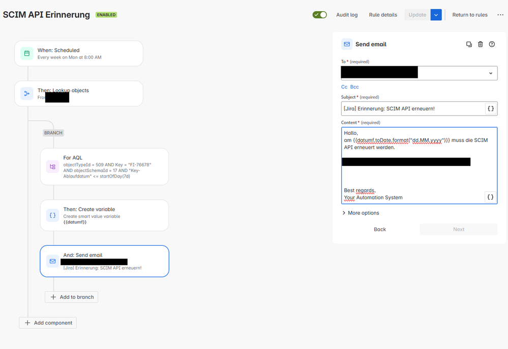

I figured it out.
Variable: {{object."Key-Ablaufdatum"}}
Mail: {{datumf.toDate.format("dd.MM.yyyy")}}
thank you!
