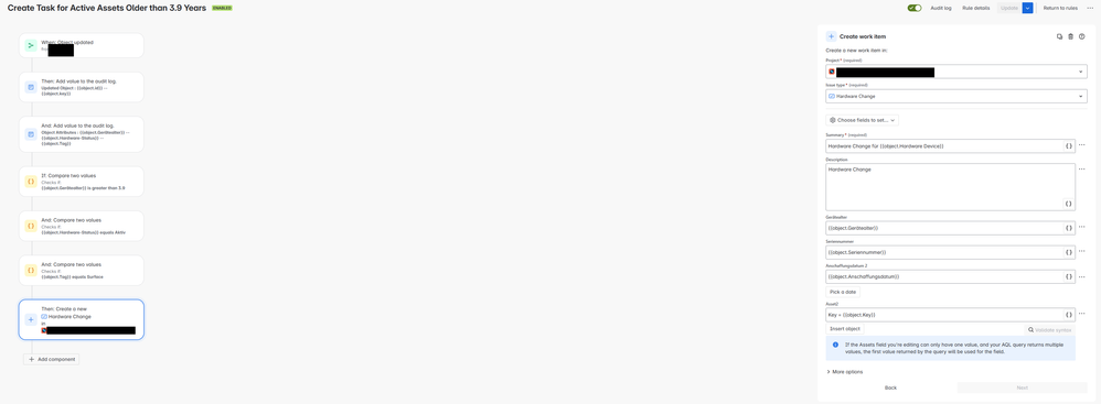

I tried:
type = "Hardware Change" AND summary ~ "{{object.Hardware Device}}"
But it still created a new work item with the same name:

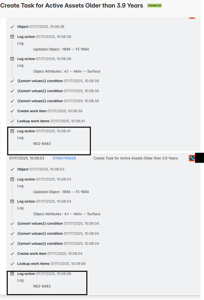

What does the log provide if you make a log action {{object.Hardware Device}}
Other option on creating the new issue, can you set the asset field in the issue based on the object that is changing?
Then in the lookup you could JQL on: type = "Hardware Change" and <assets-customfield> = <object-set-in the-field>

Log:

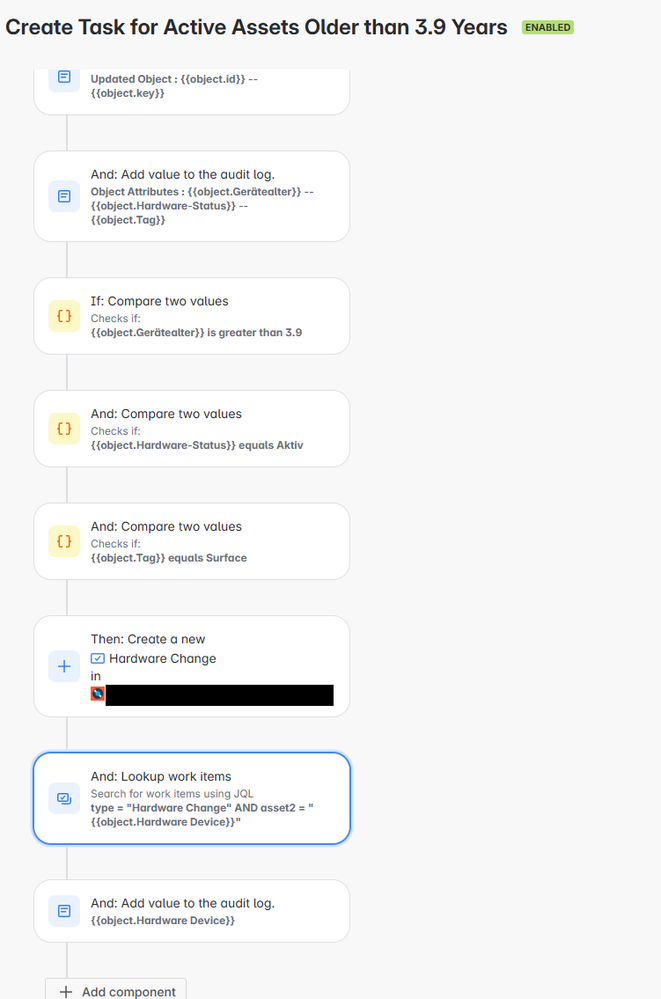

So, the Asset Custom field is called "Asset2" :
type = "Hardware Change" AND asset2 = "{{object.Hardware Device}}"
Do you mean like that?
Object.hardware Device is the asset label
I tried it, but it doesn't work.
So, here is the updated rule, maybe the order of the actions is wrong:

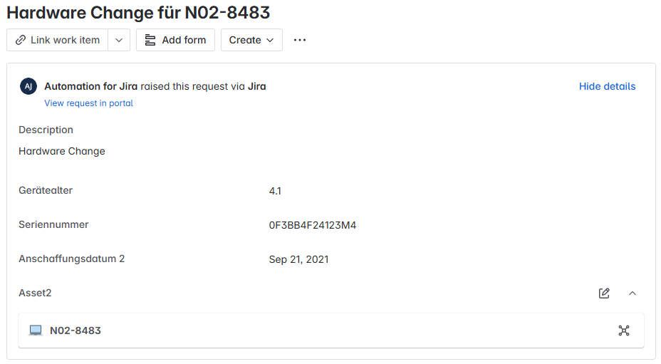

What kind of information is in the newly created issue.
Is the field asset2 on the new issue, is this an asset field and if so what is the value of that field in the new issue?
The JQL we need is to find details on the new issue, so it will determine if this is already there, so no new issue will be created.
Now the rule doesn't work at all anymore, and I have no idea why. Not even when I undo the changes. There's nothing showing up in the logs either—only that I made some changes. But at least now you can see what kind of custom asset field it is. And that could also be used to identify the tickets

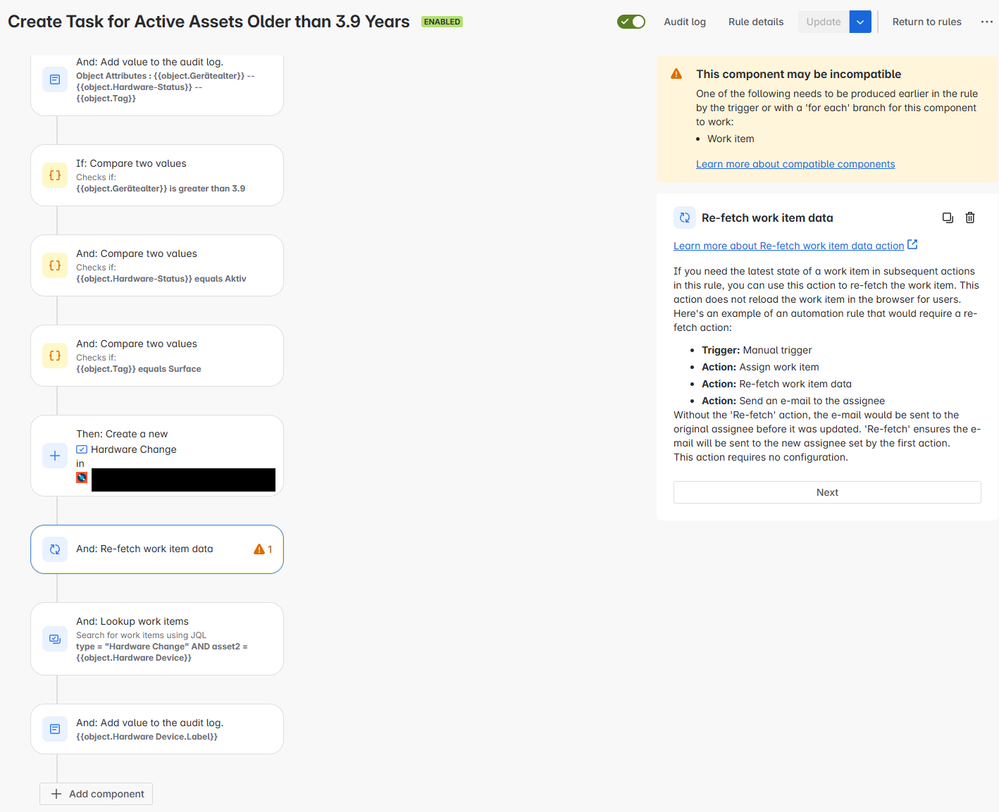

Antonia
July 17, 2025

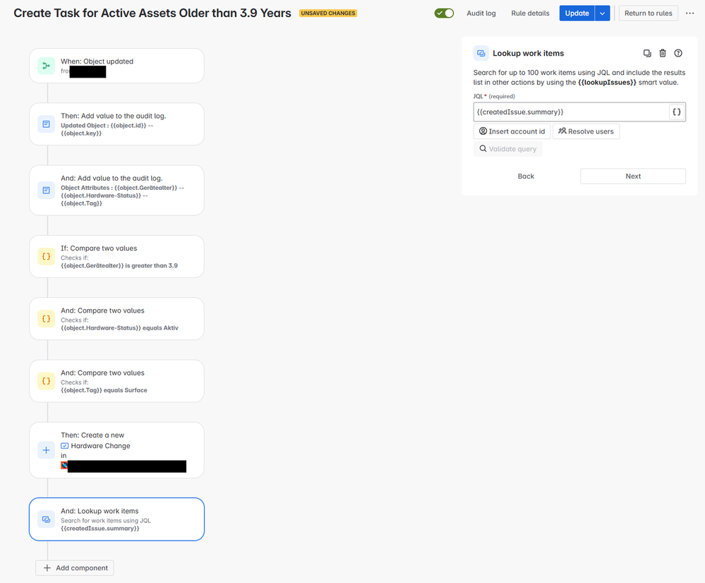

Log says:
Can't run component as it requires work item(s) in the context. More than likely you have a trigger that doesn't insert work items into the rule chain. e.g. Scheduled rule not running a JQL query. Creating a work item does not put a work item into the context, you have to branch on it to update it.
Marc - Devoteam
July 17, 2025
Hi @Antonia
Then use a branch, based on most recent created issue and do the lookup in the branch, also the log action for the time being

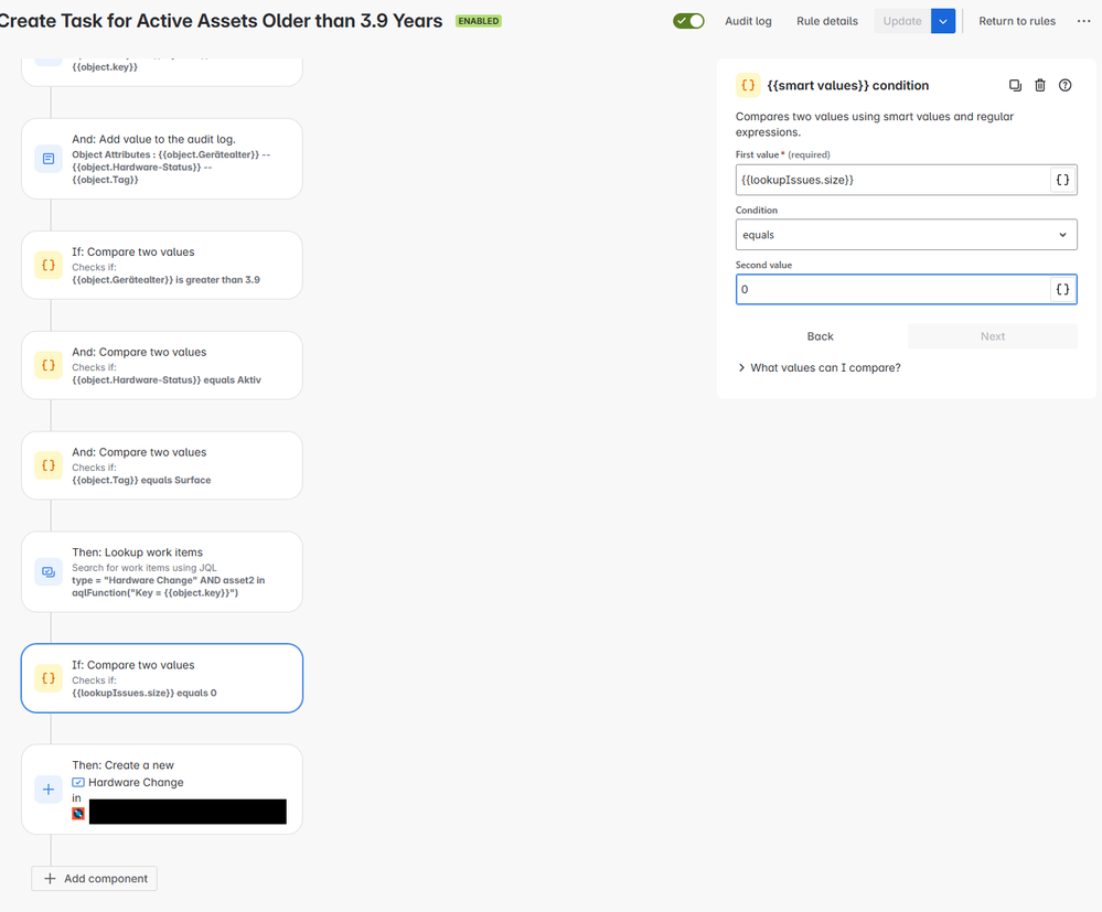

I made it! I done it a bit different like you said, but it works:
I have moved the lookup function up one and then a smart value is added and only then is the ticket created.
