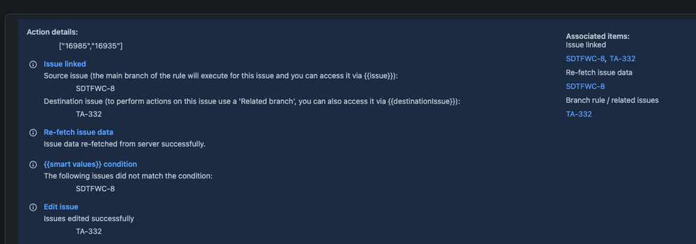

I tried your solution, but for the Service Desk ticket I can't even manage to get a comment published - so the formula doesn't work.
I'm starting to think that it doesn't work perhaps because I'm trying to make changes in both a Jira project and in a Service Management one via one single rule?

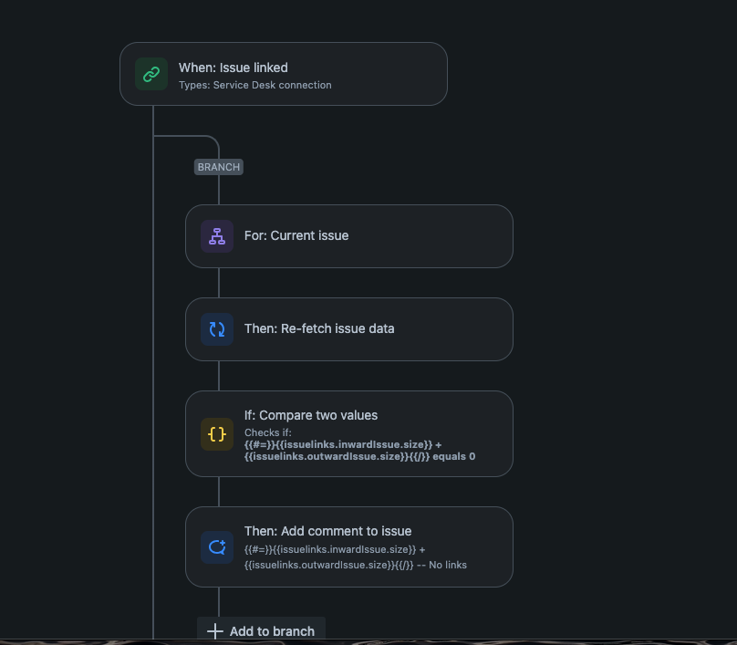

Here's the configuration and the logs, perhaps you can share some more insights? Screenshot 2024-05-23 at 11.05.51.pngScreenshot 2024-05-23 at 11.05.39.png

The If condition should be right after the trigger, not inside the branch.
Also, I am not sure why you need a branch.
