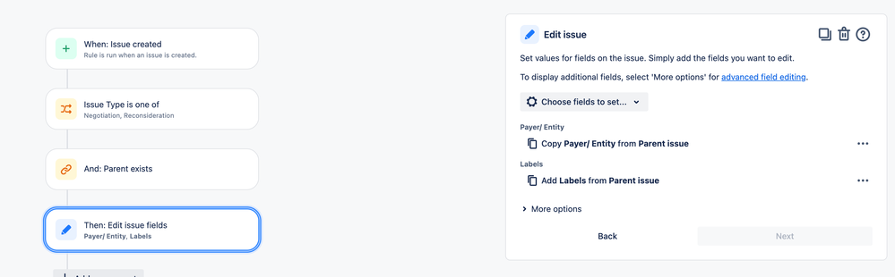

This is what I currently compiled based off some forums I found and some YouTube videos. Also I don't know anything about JSON or JQL coding :(

You have the correct trigger. The rule will be triggered when an issue is created.
If you want the rule to proceed only if the created issue is a child of an epic then you need two conditions:
1. A Field Value condition: Issue type is one of... and select all the issue types that can be direct children of Epics.
2. A Related Issues condition: Parent exists
Then in your Edit action select the field you want to copy from the parent Epic to the newly created issue.
For each of those fields click the ... Button to the right of the value entry field and select COPY. That will prefill the entry field with a statement "Copy <the field> from Current Issue".
Click on that text. That will open a pop up with two pull down fields; one for selecting the issues to copy from, and one for selecting the field to copy from. Change the Issue Field to Parent.

1. Inheriting Rule: It was successful and i cant thank you enough for the help. For anyone who may need this here you go:

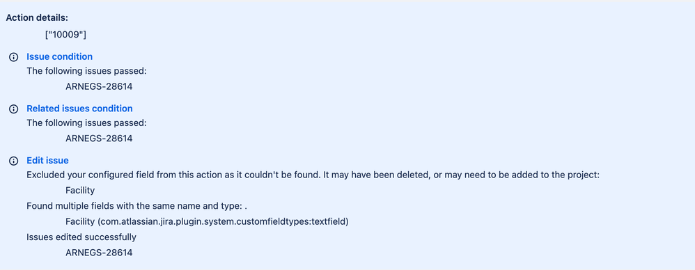

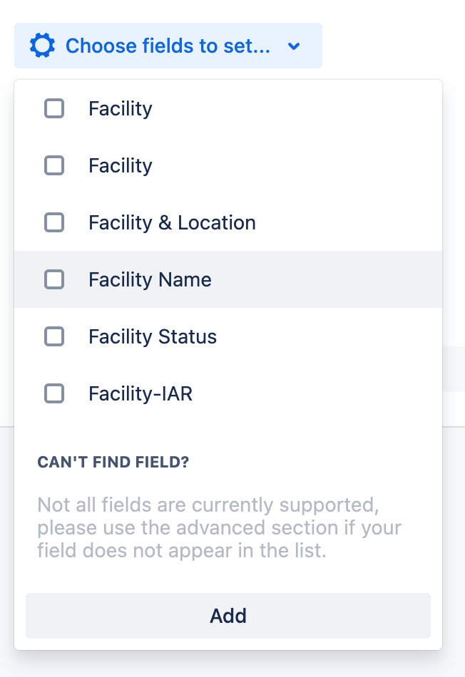

I did run into a problem but only because there is a field that is very common among other projects on our account so the automation keeps failing for that field:
I tried to rename our project specific field but it does not appear on the list (Facility.) just added a period to make it stand out. So it suggested I use Advanced Editing which requires JSON which I know nothing about. However I do know that the custom field customfield.10068 which I am assuming ill need?

#1 Is the Facility field one that you can edit manually for the issue? What is the field type for that field? You may indeed need to use Advanced Editing. We can provide specific guidance when we know the field type.

1. Yes, the Facility is something we manually input. It is a short text field. We did want to utilize the drop down or checkbox field but we are limited to 55 options...

#1 to use Advanced Editing to set the Facility field you would use this code
"fields":{
"customfield_10068": "{{issue.parent.customfield_10068}}"
Make sure that there is no other code in the JSON field other than what I've shown above.
