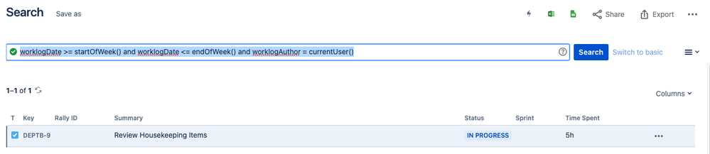

1. Write and save a filter that queries for all work logs added during the week by the current user, e.g. worklogDate >= startOfWeek() and worklogDate <= endOfWeek() and worklogAuthor = currentUser()
2. In the filter results, add the "Time Spent" field.
This is illustrated below as follows:
Team members can scan through the list and determine if the time spent on the issue has accurately been logged. This filter can be written once and used by multiple users on your team.
Your team may need to manually add the time spent hours in this column if they're required to log a set number of hours each week, unless any existing applications you have support this. If this is an edge case scenario, then I think the filter plus Time spent column is the best route to take.

Hi Samuel,
this only works if there is no time spent by another team member, otherwise the 'Time Spent' field shows the sum of all times from all teammates.
I don't think there is a solution out of the box to display the sum of your own times.
My solution would probably be Scriptrunner or a script that uses the REST API.

Sam Nadarajan
April 5, 2022
This is correct, I'm making an assumption that that's not the case here, but this wouldn't give us the real picture of time logs if multiple users are logging time on one issue. I think this is the best native, least technical solution available, but it can quickly fall apart.
Depending on how serious the need is here, it may reach a point where getting a marketplace application is preferred. I think Tempo Timesheets or some other time tracking application will help here!
