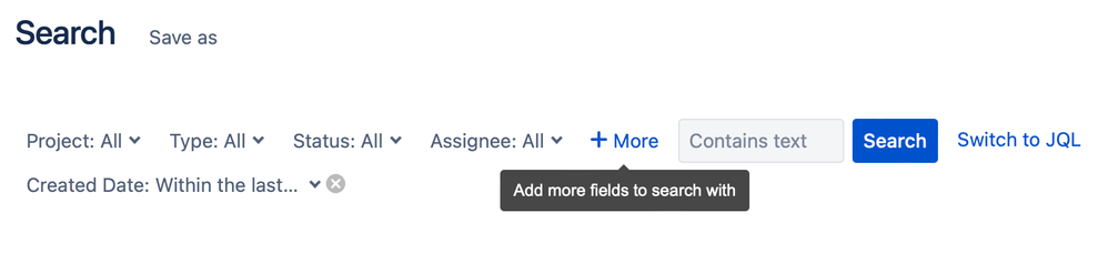

Hi @Calvin ,
Do you mean the issue search on the User Portal, or the Issue search using Basic/ Advanced Search?
Since you mentioned JQL I'm guessing the second. If so, you should be able to add any field from the "more" button. Using this I can select any custom field that I have made.

Thanks for this. Is there someway you were able to make this happen? This is for Jira Service Management (JSM) and not Jira Software right?
For some reason mine just comes up with the original fields that came with the software and I don't see any custom ones.
No this worked out of the box for me, no additional configuration needed.
