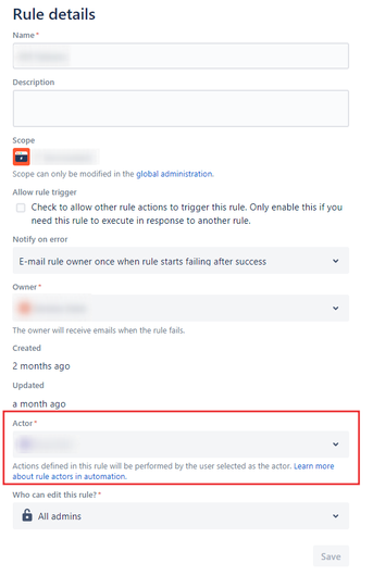

Hi Suzi thanks for the reply,
Right that makes a lot more sense and I have found a rule that says 'comments updates reply status' in automation. However when I click on it and look to edit the automation I can't find anything to do with acting as a specific user. This definitely looks like where the problem lies though.
Like Suzi Firth likes this
Suzi Firth
March 16, 2023
Hi Josh,
It should be in the initial screen once you open the automation:
