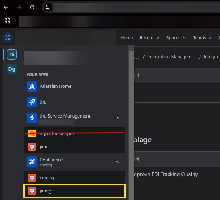

We went admin.atlassian.com > Products > Add product. There during the creation process we added it to jira. In our Case it's called Jiradg.
I have provided a screenshot here.
What is in the yellow box is a new site that was automatically created by the JSM which is named the exact way as our Jira. I supposed it's because we selected add to existing -> jiradg in the beginning of adding the product.
(the crossed out red JSM will be deactivated shortly. That was the first one attempt where we didn't press add to existing and instead clicked "create new" and then there waas no connection between jira and jsm)
Our current domain setup is:
jiradg.atlassian.net for Jira
jiradg.atlassian.net for JSM
confdg.atlassian.net for Conf.
jiradg.atrlassian.net for the new conf that was created by JSM (I don't want this)
Thank you for your help!

Ah yes - now I see. I have had to play around for a bit to see how different sites behave and can you link those somehow to get knowledge base integration running.
A note before we begin, how it's usually implemented is that all products are under the same site/same domain. I'm not sure why it was implemented that way in your org, but you have two different sites for Jira and for Confluence. 👀 By default sites = URLs so you have:
  • Site 1 > jiradg.atlassian.net (Jira)
  • Site 2 > confdg.atlassian.net (Confluence)
Again, it would be much easier if you would have just one site for all your products. If you would proceed with this, I would suggest checking the following article/guide.
Now, as for the issue itself. It seems that for connecting JSM and Confluence (as a knowledge base), these two need to be under the same domain/same site as per official docs:
When linking spaces from Confluence cloud sites, make sure that the Confluence site and Jira Service Management site have the same domain name.
That being said, ⚠️ you will not be able to connect Confluence from confdg.atlassian.net with JSM from jiradg.atlassian.net. There's a feature suggestion for that: JSDCLOUD-5782: Support linking non same domain JSD Cloud instances as knowledge base
If you wish to stick with two different sites/URLs, the suggestion is to:
  1. Delete/remove JSM and Confluence products from jiradg.atlassian.net
  2. Add new JSM product to Confluence, a.k.a. confdg.atlassian.net
This would then result in the following:
  • Site 2 > confdg.atlassian.net (Confluence, JSM)
Again, if possible, my final recommendation would be to put everything under the same site. Meaning, either:
  1. Migrate Jira to confdg.atlassian.net
  2. Migrate Confluence to jiradg.atlassian.net
👉 If you do so, you can easily change product and site URL by following the official guide (note that there are some limitations). So, you could rename it to something like <org-name>.atlassian.net and then URLs for products would be:
  • <org-name>.atlassian.net/jira > for Jira and JSM
  • <org-name>.atlassian.net/wiki > for Confluence
To sum it up - you initial thinking was correct. Due to your org setup (you have 2 different sites), if you have chosen Confluence instead of Jira, additional Confluence wouldn't have been created. This is because products are connected to sites as your organization can have more sites and therefore, more identical products.
