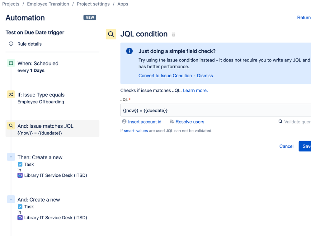

I am using the HR Service Desk. An exiting employee has a resignation date and a termination date. I have a couple of questions:
It will look something like this although this one does not work.

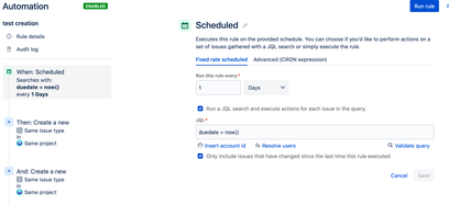

How do I set up the automation to run when the termination date is today?
The logic of the automation rule you created seems to be correct, however, there are some minor JQL errors. Please, create the rule following the template below:

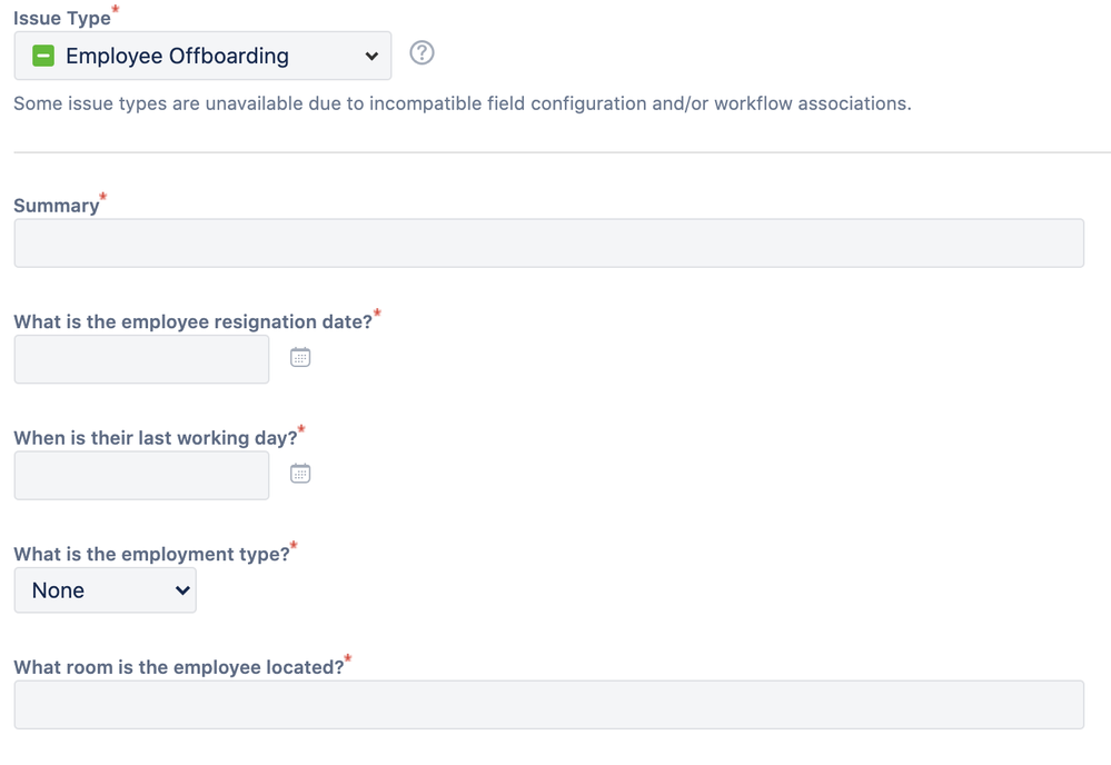

That was helpful. When I follow your example, it does not give any errors which is a step in the right direction. When I run the rule, it does not give me the result though. Here is part of the form that creates the ticket.
Since this was a default request type, I looked in Admin | Issues | Custom Fields and found "Last working day" as the field name.

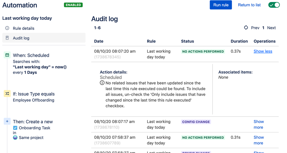

I created a test ticket with today as the last working day and then created and ran the rule that is similar to yours, but it doesn't return the results.
Do you have any suggestions?
Hello @Margaret Winward
As displayed in the rule audit log, the JQL query you added didn't return any issues that were updated after the last time this rule was executed. This mean two possible reasons:
"Last working day" = now()If the filter does not return any issues, you might not referencing the correct field there or you don't have any issues which "Last working day" is today.
Let us know if you have any questions.
The wrong field was selected. Your troubleshooting process helped me find the correct one. Thank you!
