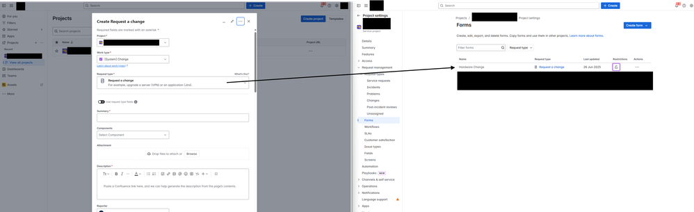

I have selected the same request type "Request a change", but I don't see it anywhere in the ticket when I create it. Is this even attached to a ticket?

It looks like you've correctly linked your form to the "Request a change" request type in your project settings.
What's happening
The form is linked, but it only shows up if:
  • You're using the customer portal (Jira Help Center), or
  • You turn on the little switch that says "Use request type fields" in the issue creation screen.
If that toggle is off, you're just using the default Jira issue view — so the form won't appear, even if it's connected

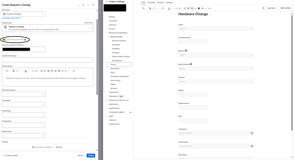

Hi @Olha Yevdokymova_SaaSJet
thank you, for your help, but I have now switched the toggle, but unfortunately the fields that I have defined in the form are not displayed.
I have also compared the fields and there is no field from the form.

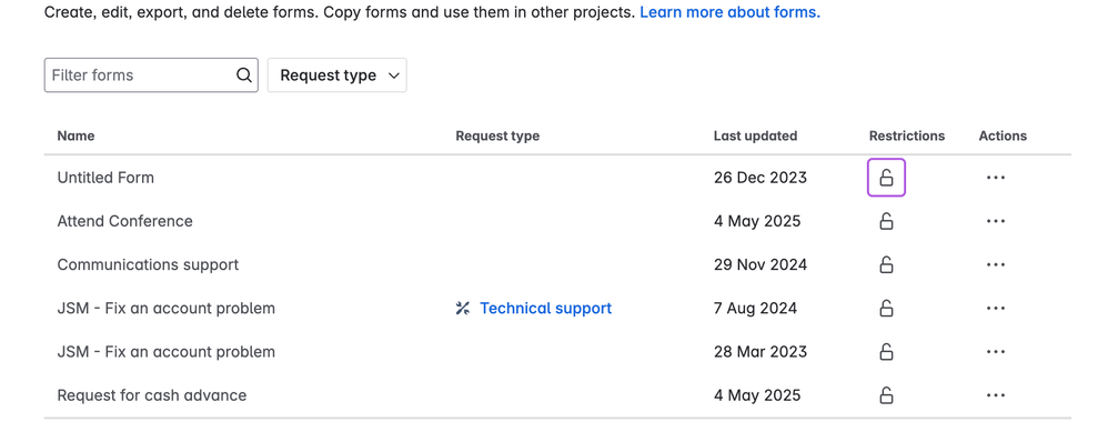

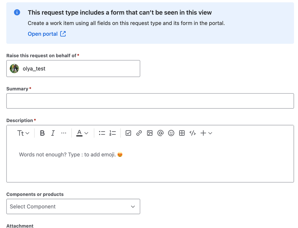

Yes, unfortunately not all fields is avaliable in this view, you may even see this message.Screenshot 2025-06-29 at 20.36.22.png But if you will be okay with the fields avaliable you may try to check if the form is tied to request type you choosed in form settings. For example here only one form is tied to request type so I can only see some of avaliable request form fields for the technical support request type. Screenshot 2025-06-29 at 20.39.02.png
But JSM forms was't designed for this type of in issue forms, so that may be limited solution.

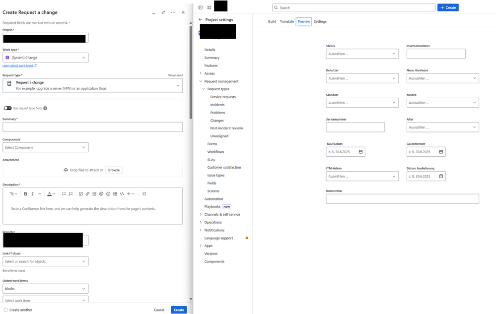

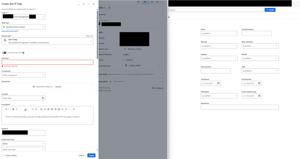

thank you for your help, but sadly it doesn't work either.
So, I disabled the checkbox "Attach to request types" and tried to create a  new ticket, but the fields are not the same (see attachment). And when the checkbox is activated and I chose a request type , it makes no difference. I can only attach a form outside of creating, but I never have the fields during ticket creation. I also don't get the message that you get. I have cheked the fields several times, but none of the fields from the form appear in this mask.
Without request type:
With request type:
