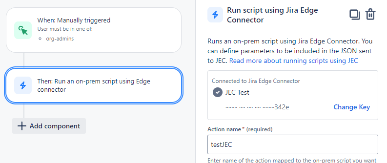

Automation should trigger action testJEC. Also I used apiKey generated here in the config file.

So after all this set up, when I trigger my automation, it should call on-prem JEC through Connection and through config file it should select action testJEC which should run a script othertest.py as defined in config file. But nothing happenes. So what am I doing wrong?
