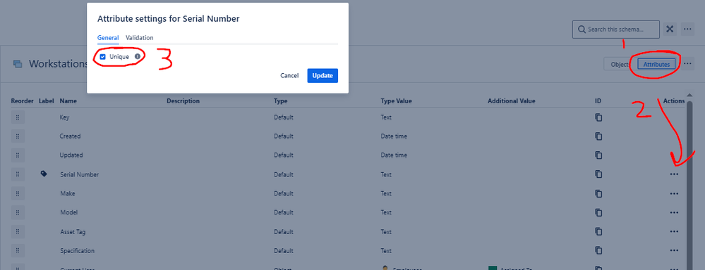

July 1, 2025
Hi @Bharat Kumar Bondalapati ,
If Job Role is an object then you can go to the attributes for Job Role and set the Name attribute as unique. I'll include a screenshot below of how we set our Serial Number to be unique for workstations
