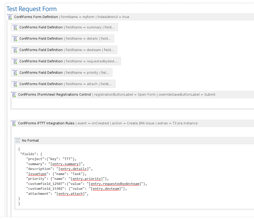

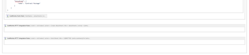

When using Confiforms to create a Jira Issue, I'm trying to add files as attachments that get submitted with the form. The Jira issue (and email) are being created, but the file isn't attaching to the Jira Issue. I've looked at some other questions here and can't seem to get it working correctly.
I would like to use the Form Field with a fieldname of 'attachments' (a field type of File/Attachments) as the file selector to upload and attach the respective file to the Jira Issue.
Any help is highly appreciated! Here are screenshots of my setup.

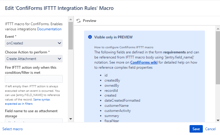

Do you want to create a new attachment and attach it to the page?
Or just upload an attachment and pass it over to Jira?
Alex
@Alex Medved _ConfiForms_ Thanks for the reply - I'll mark this as answered - I was trying to upload a MS Word document, which isn't accepted, but the other file types (.pdf, .xls, etc.) that are supported did end up attaching both in the email notification and in the Jira issue. Thanks!
Regarding just upload an attachment and pass it over to Jira?
I've build a form that just creates a Jira issue.
I can't get passed this error using the field definition marco file/attachment
com.atlassian.sal.api.net.ResponseException: Error communicating with Jira, {"errorMessages":[],"errors":{"attachment":"Field does not support update 'attachment'"}}
How do you pass the attachment to Jira? what is your configuration?
Hi
Please remove the part with "attachment" and add a ConfiForms Field (field name parameter set to attach) macro inside the IFTTT macro
Like in here
Alex
That did it. Thank you so much. I had tried that prior but I was using field definition twice instead of just field.
It has to be ConfiForms Field, as this way you reference a field...
Field Definition defines the field and it's type - and really is part of ConfiForms Form Definition only
Thanks again Alex.
