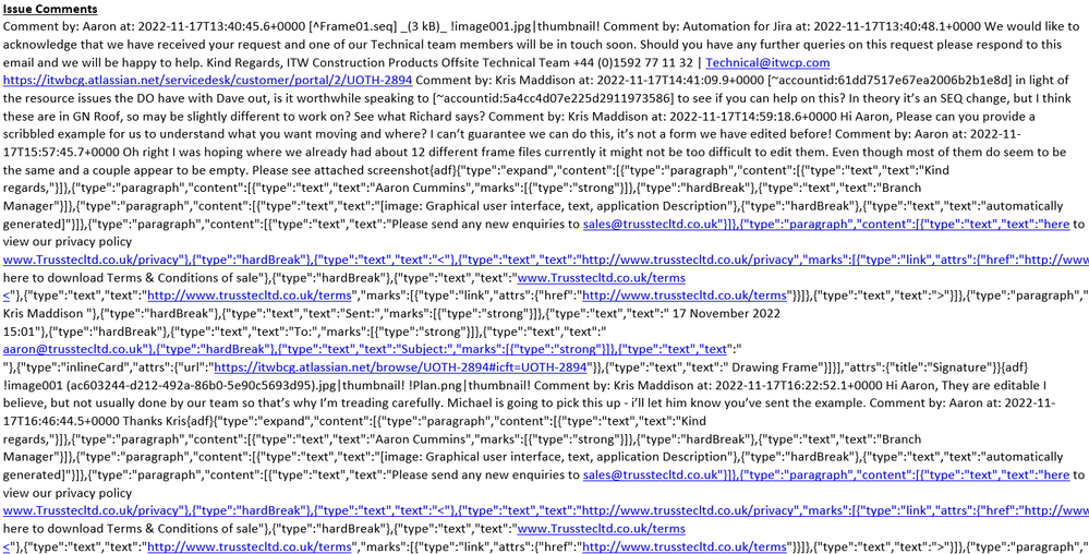

A lot of our design team need to "book out" specific issues as they prefer to work offline rather than online, so we often use a pre-made automation system that allows them to receive an email with that issues:
  • Description
  • Attachments (Links)
  • Details (Name of Reporter, date and time created etc.)
  • And most importantly, a list of all comments sent into the issue.
The problem is that when using {{issue.comments}}, the output of the comments is as below:
All I know regarding this issue is that the extra detail is due to how Jira handles signatures using PNGs and so forth. Using {{issue.comments.html}} makes it return blank. Was wondering if there's another way to have the comments come out in a more clean fashion, whilst also including: the commenter's name, time the comment was posted, and any other information.

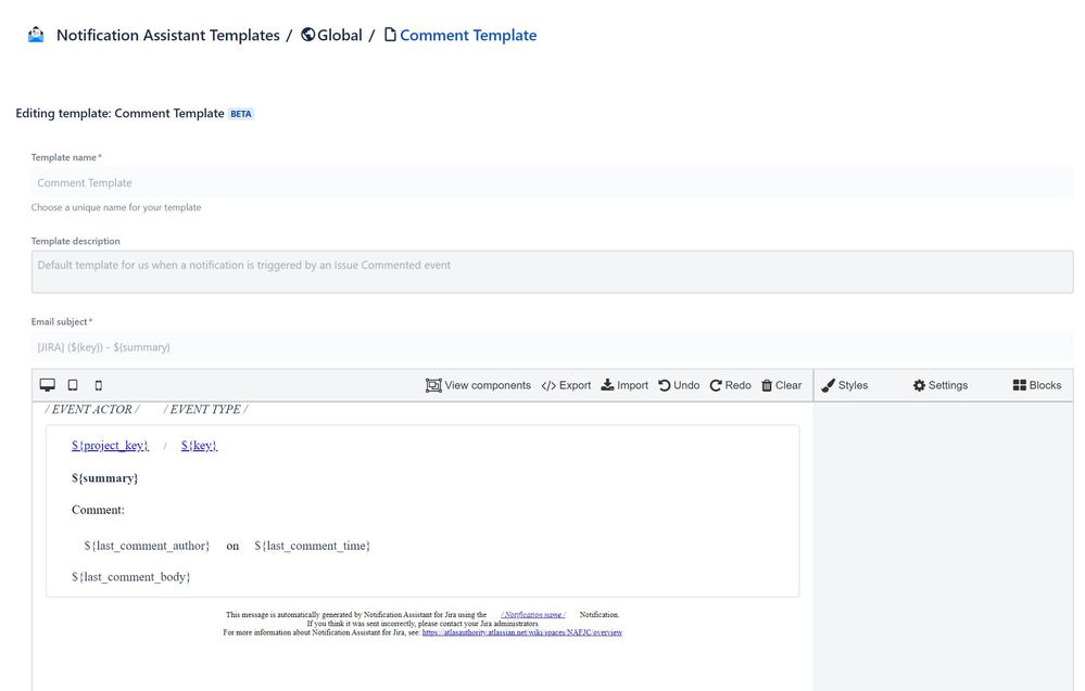

Notification Assistant for Jira supports up to the last 10 comments in a template if you want something a bit better looking:

Shan McQuown August 29, 2023
@Boris Berenberg - Modus Create This template is perfect for what I am looking for, but I can't seem to figure out how you built it. Is there anyway you can share it with me please?

This is the default Comment template in Notification Assistant for Jira with the last 10 comments enabled. Feel free to contact our support team (https://atlasauthority.atlassian.net/servicedesk/customer/portal/1/group/1/create/1) if you need help.
Shan McQuown August 30, 2023
@Boris Berenberg - Modus Create I reached out to support. I do not have the option to enable last 10 comments in advanced settings and my default template doesn't look nearly as good as yours when previewed. Capture.JPG
August 31, 2023
Hi Shan,
Actually I realized that I said it wrong. That screenshot was a customized version of the Single Issue Template and I added the Last Commented field to it.
Do you have Issue Commented as a trigger in your notification? I believe this is required to get the 10 comment option to appear.
