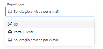

Entendi como funciona, realmente a issue type do tipo solicitação enviada por email só tinha aquela request type. Conforme eu criei novas request types somente com campo description e summary, apareceram pra mim:

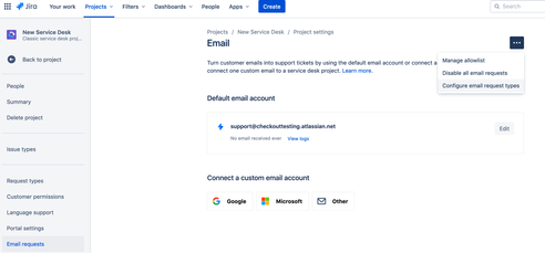

Request types can only be switched via the edit screen when there are mutliple request types tied to the same issue type. The reason you can't switch is because there is a special issue type called "Email Request" which is in use for all email requests.
To change this, you would need to navigate to Project Settings > Email Requests > ... > Configure Email Request Types and pick a different request type.
Please keep in mind when selecting the request type that there are certain requirements to use a request type  for email. It must only have the Summary and Description as required.

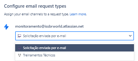

When I go to "configure email requests", I only see "treinamentos técnicos".
When I choose this option, the e-mail trigger doesn't work.
How can I enable or even create a new request type to have the requirements to appear in the configuration above?

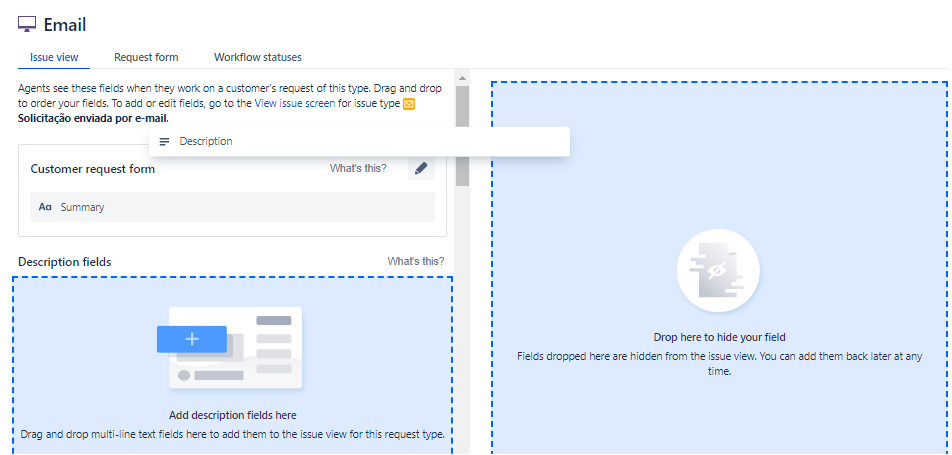

You told me that the only fields necessary are Summary and Description.
I'm trying to create request types to fullfil this requirements but I can't as wel:
The result I expect is to enable agents to change the request type to the correct request type when a "e-mail request" arrives.
