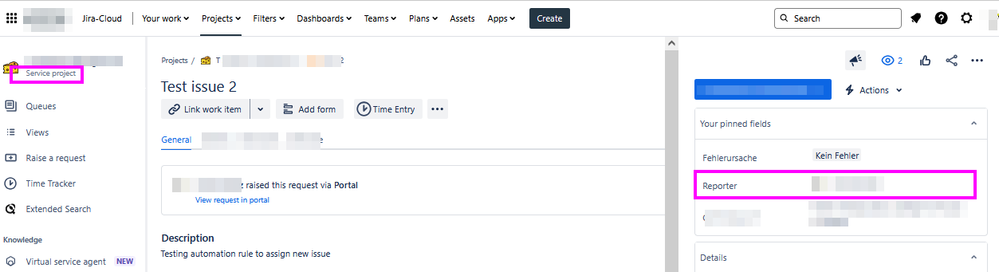

While I can change the reporter of an issue in a software project, this seems not to be possible in a service management project when a ticket has been created via the portal.
How to achieve this?

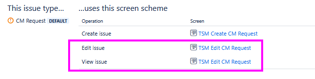

Hi @Jochen Betz , in addition to @Vitalii Rybka 's suggestions, I'd offer that you can also add the Reporter field to both Edit and View operational screens in the right-hand section of the screen. Since the Reporter field is on the Edit screen, you can then edit it. The reporter still shows up in the main section but it's not editable.

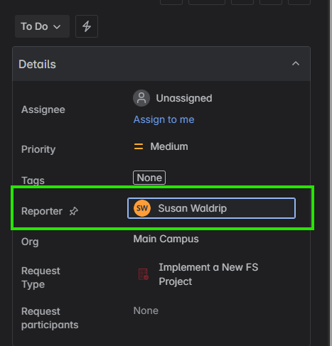

Hi @Jochen Betz , I must not understand your request because I'm using JSM (we don't have Jira software/platform). Would you please post a screenshot of your screen so we might provide better suggestions?
Sure I can, but there is nothing different from your screen shot except that reporter cannot be changed.
BTW: Person logged in and reporter are the same person aka me which is admin of the project.
Did you add Reporter to both Edit and View operational screens (or the Edit/View screen, if that's your configuration)? If so, then I'd suggest contacting Atlassian support at https://support.atlassian.com/contact, they should be able to see if anything's going on w/ your instance and provide a solution.
Yes, because they use both the same screen.

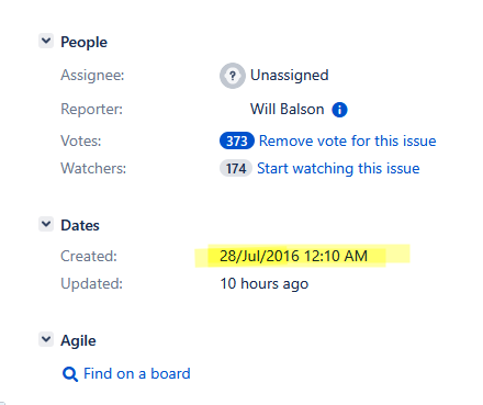

Hi @Jochen Betz - It sounds like what you are really looking for is the ability for a customer to raise the issue on behalf of someone else. You can vote for and follow that request here:
https://jira.atlassian.com/browse/JSDCLOUD-4102

Voting for an issue at atlassian? ... not intending to work that long in my life to see it become closed (not even saying fixed); more likely because "not implemented".
Sorry for that permission, but reality proofs it.
And looking at the exact issue you are referring to... 9 years seriously? Nowadays SW companies don't even exist that long anymore.
And still..... nothing happened: UNASSIGNED
That's what Atlassian calls "We listen to our customers". Well "Listen" yes, act? No.

Key point: The reporter field was missing in the screen configuration. Meaning it was visible on the page when you view an issue, but in the configuration page it was not - and IMHO does not need to as it is a field which is always there, you can't remove it. So why add it either? All the other potential causes (at least as far as I'm aware of) has been already checked and discussed here.
So big thanks and shot out to Brigita Bizjak. Albeit it does not change all my other remarks and concerns about Atlassian products, but this call was very pleasant and constructive.
Yes, that is one that I tend to forget about for the Reporter field. But that is the way that most people would keep it from being updated in addition to the Permission Scheme. You leave it on the View screen so it can be seen, but you take it off of the Edit screen so that it can't be updated. Glad you got it resolved.
That's strange that you say that. For me it does not make any sense to "take it off" the edit screen - because it will be visible there anyway. This is pretty confusing. IMHO you should use the permissions for what they are intended to: to give/restrict permissions and not this hack
This is the normal way that Jira controls whether you can edit a field. If it is on the View screen and the Edit screen then you can both see and edit the field. If the field is on the View screen and not the Edit screen, then you can see the value that was created, but you cannot edit the field using the screen. There are other means for Jira Admins to setup to limit who can then edit the field, but that's a more indepth discussion.
It's just strange that someone would remove the Reporter field in this instance since there is a Permission that can be set specifically for that field in the Permission Scheme. Other fields, including custom fields, do not have that available in the Permission Scheme - therefore the above is used to control editing.

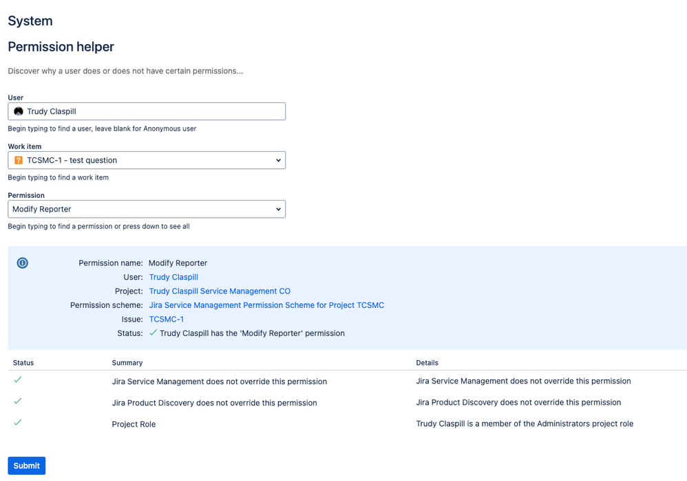

Have you tried using the Permission Helper to see if that reveals any more information about why the Reporter can be changed by a specific user in a specific JSM issue? That tool is available to Jira Application Admins through the System settings.
Thank you @Trudy Claspill for the longer explanation and looking into the topic.
Let me roll up from the bottom:
Yes, I have used the permission helper. And even myself as admin and with service agent license can NOT change the reporter, albeit the permission helper says I should (all green)
