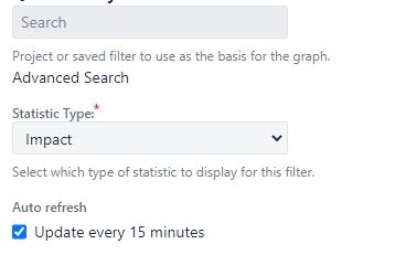

Where do I find the options associated with "Statistic Type"? I want to edit them - they are clearly custom field options but I do not where the associated screen is meant to be found (if this is the correct case).
Hi Elizabeth,
They are just custom fields that have set values - like pick lists/dropdowns/user picker fields, etc. You cannot use text fields or number fields.
Hi John,
So to clarify, all custom fields in my instance will show except those that are text or number fields?
