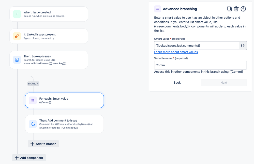

I stumbled upon this discussion on the topic and following the linked knowledge base article to set up the automation rule like for like (below) but it never gets triggered and I have no idea why.
The only thing I can think of is that the trigger issue is from a different project. Anyone can help me solve this?

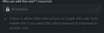

If the issue creation is being done in another Automation Rule then in this rule you must check the box on the Rule Details page:
That should solve the problem of the rule not being triggered.

@Trudy Claspill I have ticked the box within Rule details:

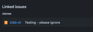

The link type within the first condition matches the type in the ticket:

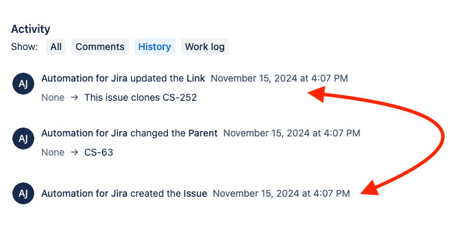

I suspect that the action that is creating the Clones link between the issues is happening after the new issue is created. This rule is triggered when the issue is created, and executes before the link is created.

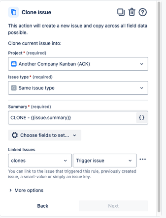

I created an Automation rule that uses the Clone Issue action, and within that action I updated the Linked Issues field to link the new issue to the source issue.
When I executed that rule, the history of the newly created issue shows that the issue was created and then separately the link was added.
Try adding a Re-fetch Data action or a Delay action after the trigger. Re-fetch may also happen too fast, before the link is created.
