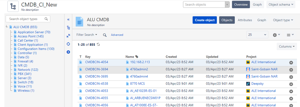

I have added asset objects with Object Schema as "CMDB_CI_New".
Added Object type as "ALU CMDB" and through CSV import loaded CI data into "ALU CMDB".
It has an attribute "Project" which should dynamically appear in the custom field "Configuration Items" in the issue form.

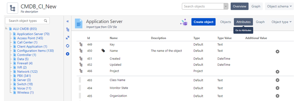

If it is on prem. You should be able to filter the objects via the issue filter scope. You could try:
Project = currentProject()
This should work, if your Project attribut is actually of type project.
