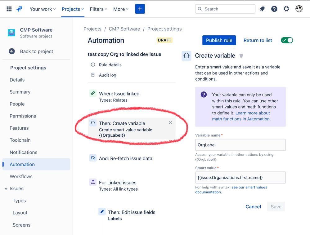

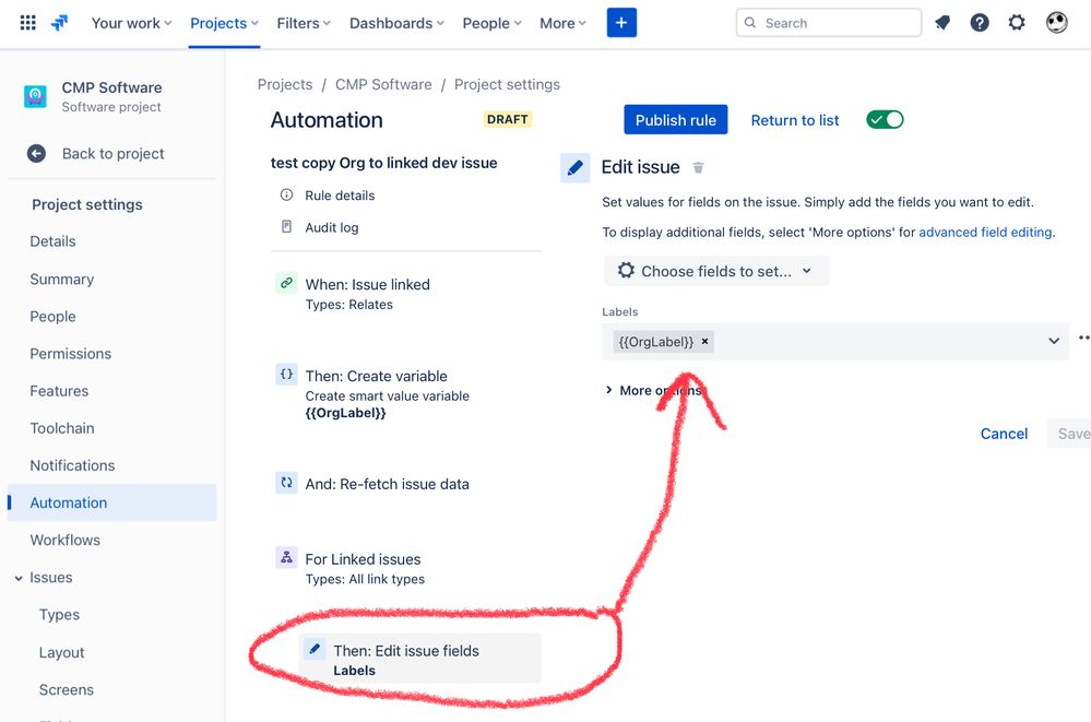

Here is what I came up with...
The process is to link the JSM to the JSW from the JSW issue. This could be reversed I think.
I used the Create variable action to store the Organization into a smartvalue. I then referenced the variable in my action to add the label.
Regarding the issue of multiple organizations I'm not sure TBH. Will need to play with it.
