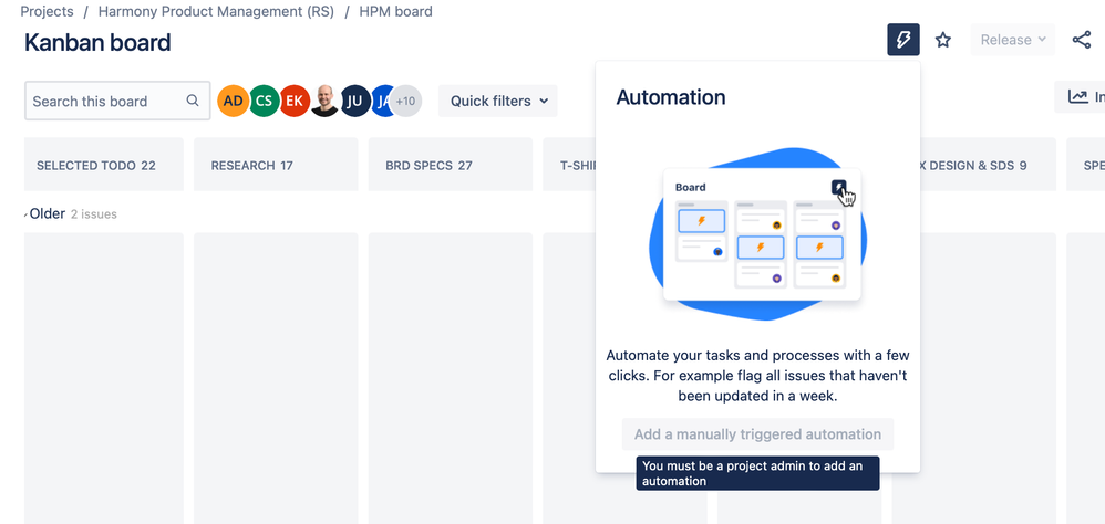

I think I should set trigger from the following Kanban board. Is it correct?Screenshot 2023-07-20 at 15.15.47.png

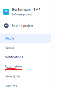

And I found some of our projects doesn't have this lightening mark! Then how can I set up trigger?
John Funk
July 20, 2023
Go to Project Settings. Then Automation.
