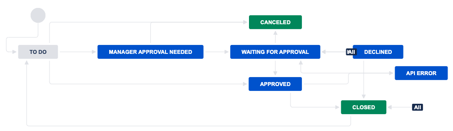

You can do this using automation and the approval process in JSM. This is how we do it for our automated application requests. The first approval has to be by the manager, and once approved it goes to the system owner(s) for approval. So you could do something similar where the first approval is by the department head, and when they approve, send it to security.
This is how our workflow looks like:

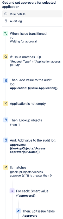

Could you also show me what your automation side looks like?
I have multiple automations because we are using tray.io to do some of the automation like getting the manager and notify them and the system owner via Slack and add the user to the right Okta group. We store the application information in Insight, so the automation to get the system owner looks like this:
