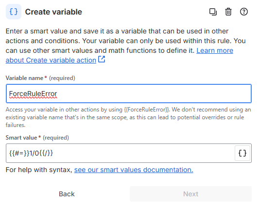

I need to test a new account with a list of people in it that I set as an Automation owner, so that all this list of people will receive a notification email when an automation Fails.
I am trying to test it.
For the test I need to create an automation that will 100% fail, but I am not succeeding. It keeps saying Issues accrued in the Automation log, but not automation Failed.
Please advise scenario that will make automation fail.
I would set up an automation to send a webhook and deliberately include invalid JSON so that the response code is an error
Or even simpler, just configure a Send Web Request action to https://makeMeFail
