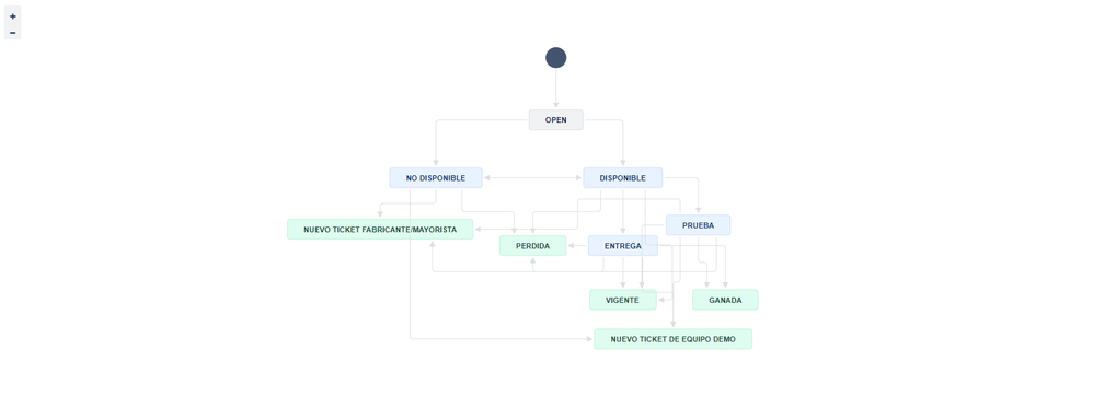

Hello! I would like to know how I can declare a state of my flowchart as closed, since I saw that there were two types of "in progress" state, "In progress" and "ready". But in my statuses that are with the "ready" type, they are not closed, from what I read, the "ready" status is a "ready to close" but it is not the "closed" status, I would like to know then, how do I configure a status, to be able to close a ticket.

In case of this issue, I not nokw whats is wrong whit my WF.
Is when i investigated, and I discovered that the status in green, is not necessary to be "closed".

But several tickets are already in any green status and still appear as open.
According to the WF, after that they can no longer be edited. That's what I don't understand. Why are they still open if they are already closed?
Are you stating that those issues are still editable? Using the out of the box WF and status, when an issue is at the terminal status, edit is restricted.
Are your WF status something that you created new? In addition, are those issues' resolution field is not populated?

Yes, they were created especially for this flowchart.
I insert the image of how they appear even when open.
Hi Sofia:
It seems that when issue moves into the status in question that your WF's transition is not populating the "Resolution" field. You will need to update your WF setup and publish the change.
Afterward, for all existing issues, you will need to move those issue's status to another "In Progress" category status and then move them back to the status in question.
