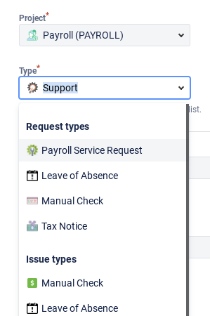

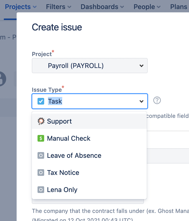

Rightly or wrongly, I have a use case where I would prefer NOT to have some request types on the portal BUT have them still able to be created. I found that I could see the "type" from the create button and tried to find the right permission to have OTHERS outside the project be able to create with that. However I can't find the permission to make it so.
My view:
Their view:
I am trying to find the permission to have non members of that SM project be able to create from the Create button by Request type. I was able to do get my screenshot with 3 of those hidden from the portal.
Does anyone know how to expose that? I got it so they had the "Issue Type" by adding JUST to create but nothing else. Is there another (or different) permission to add for them to see "Type"?

That is exactly it, @Joseph Chung Yin . 3 of those are internal (limited) use request types that I would just as soon NOT be on the portal. Not TOTAL restriction but somewhat out of view of the masses if they were available only on the Create button.
I seem to be able to get it for myself but want the broader populace to be able to use that mechanism as well.
On the hosted JSD, I had a mechanism to restrict those request types to a specific group of humans. I don't have that on JSM in Cloud.

Just tested in our CLOUD eval JSM env, it seems that every thing (Request Type -hidden from portal UI or not + Issue Type) are all included in the "TYPE" field.
Even if we exposed the "Request Type" field in the issue creation screen for our test project and it will not appear as an actual field.  I believe you are asking when authorized users use the CREATE button to create the issue, that he/she will be able to select the issue type, then he/she will have to ability to select the Request Type associated with the specific issue type.  I hope my assumption is correct.

I will do that. I have seen it in captivity where under "Type" (not the default "Request Type") the portal request types are listed first and then the unadorned issue types after that. If one creates the ticket using the first listed "Type", it creates it correctly with Issue type and request type. If I use issue type, it goes in without the Request type as expected.
